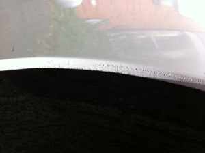

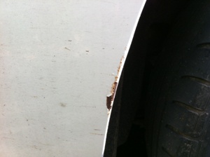

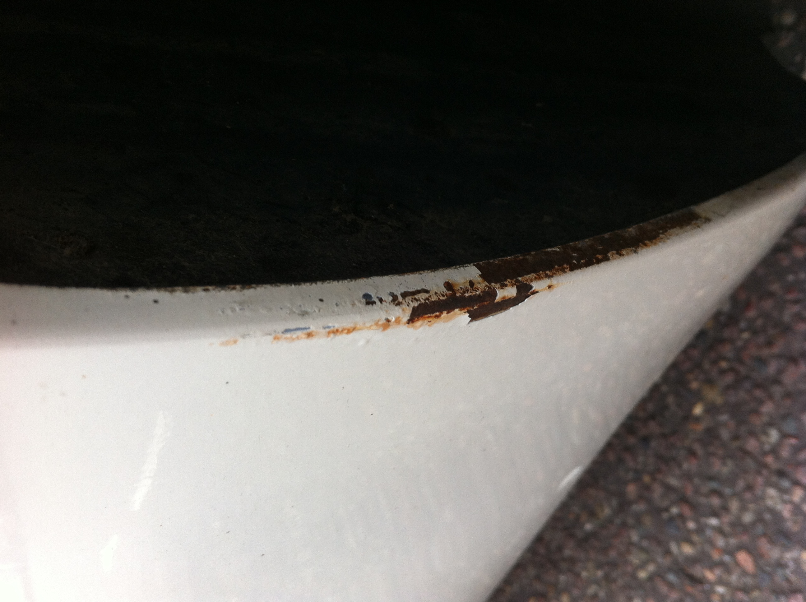

Certainly woth keeping an eye on as Fiat UK and Stoneacre believe this rust was caused by stone chips and not faulty paint and as such not covered by warranty.

Stop hunting down every thread that mentions rust and having a whine..... Your car obviously had a problem, no one else has had this issue, get over it.
Maxi - you really are Fiat's poster boy! Fiat said it was caused by stone chips - and you can see that there are many people on here who have expressed concerns about Fiat's paint quality and how easily the paint is chipped. It is in the interest of other forum members that I post these pictures to show what can happen if stone chips are not detected soon enough and treated.
Well, stone chips would have been my guess too, but looking at it with fresh eyes it looks like it was damaged and not repaired properly. The fact of the matter is that you don't know whether it was damaged by the precious owner, the dealer or possibly in transit. You simply don't know.
The high resolution picture definitely looks like a bad repair to me. Bad seal on the inner edge probably from a bodge. Not taking wheel off and just masking it from the edges with paper across the wheel. Not a repair designed to last. sent the pic to my bodyshop guy for his opinion though just incase I'm wrong.
