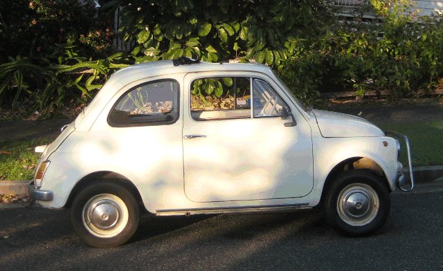

They do normally sit fairly high. The photo of the white 500 is a side shot of mine prior to stripping. You can see considerable air space both front and rear.
I'm told that they can be safely lowered about 3cm or so (~1 1/4") without either affecting the look of the car or having anything foul on the chassis, though I guess you should check with your local regulatory transport department before doing anything.
I don't know who owns the red 500, but it looks to have been lowered a bit and I'm also told that when adjusted like this, they handle even better :D
When I rebuild mine I intend to lower it by about that much.

Standard wheels on the 500s were 3 1/2"x12" and shod with 125 tyres - very narrow and tall by today's standards. The wheels had a 4x190mm stud pattern to fit over the drum brakes. The pictures I've seen of 500s seem to show a variable ride height with some sitting quite high like mine and some lower like your Dad's. In the majority of photos, the cars seem to ride high - see photos in any of Malcolm Bobbitt's books and in the Brooklands Road Test portfolios.

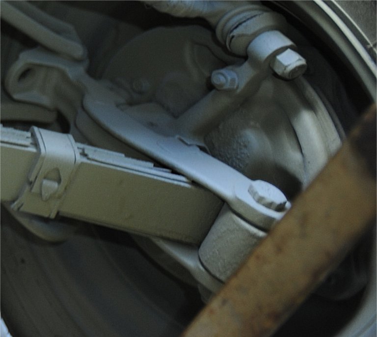

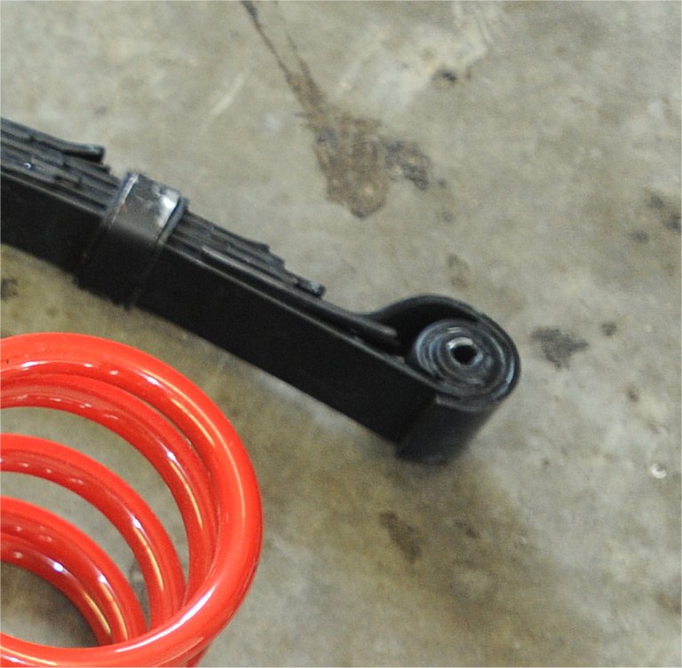

I'd be interesting to have a look at the front spring on your Dad's car. The normal leaf spring has the suspension mount 'eyes' beneath the spring line whereas lowered cars may be be fitted with a reverse eyed spring. I've tried to show this in the photos. This would be the most obvious evidence that the car had been lowered.
At the rear, the springs can have a variable amount of the coil cut out to lower the rear - usually about 1/2 to a full loop - but without removing the springs, I'd be difficult to tell, particularly if the tyres are not standard.
Once again, I'm told that wheels fitted with tyres as wide as 145s using 4 1/2"x12" rims on a lowered car shouldn't foul the body work. But then, my information may be wrong, though it does come from a firm that has been working with these cars for a long time.

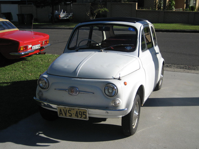

Here are the photos you requested. as you can see, it sits a little too high up front? But looking at others now, it seems that this is the norm. I have seen period publicity photos and they do sit lower although these photos show the cars with white walls and this could be deceiving.
Wow - what a find!
' :D
Any chance you could post a photo?
It would be nice to see a picture of your car anyway.
Then perhaps we could advise if it looks 'abnormal' :eek:

Actually, having looked at Chris' photos (white one) It is similarly set up if not identical in height.

No - sorry if I confused you - there is no adjustment.
I was just wondering if perhaps a non-standard front main spring may have been fitted.
Fill the tank with petrol (if you can afford it), sit a couple of people in the car and see how far the front suspension descends. A lot of the publicity shots may have had an extra 150kg or so helping to flatten the front leaf spring.
BTW, the red Fiat in the background looks like a nice (?) 124 Spider.
