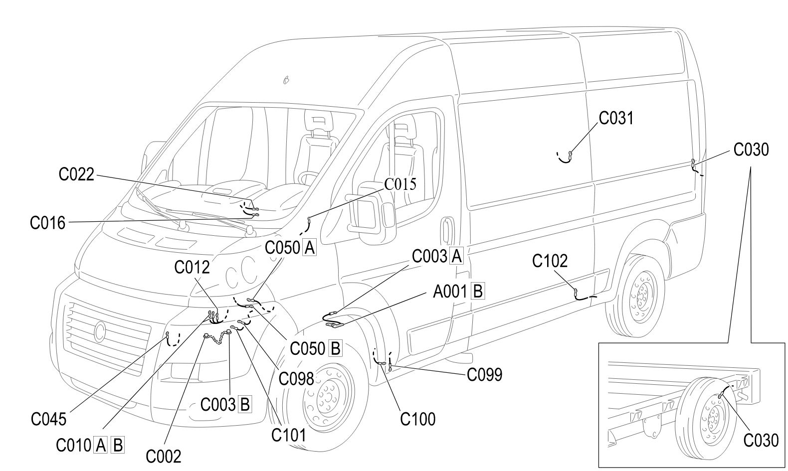

OK, found it :)
Ducato x250 ground points:
A001 main battery ground
C002 battery to engine ground
C003 battery to body ground
C010 front left ground
C012 ABS ground
C015 dashboard left ground
C016 A/C ground
C022 dashboard center ground
C030 / C031 rear light clusters ground
C045 fan ground
C050 airbag ground
C098 cabin step ground
C099 / C100 cabin ground - optionnal
C101 cabin double ground
C102 real axis ground
I've just added the descriptions for easier troubleshooting.
The x250 ground cables tend to rot in the inside (which is not visible), people add a second cable to have a better connectivity.
The ground point by the front left light cluster is one of the most problematic ones.
I'd check the ones at the back, the main ones and the ones that are responsible for the dashboard.

Hi all, took a while due to some needed free time 🙂
Checked the main and rear light unit grounds... They are all good.
Did an extra ground test on the rear light unit back plate... I was able to get rid of the error for a second so the assumtion that there could be a faulty ground was spot on.
Then i looked at the ground plate and the plug. Turns out the back plate pin for the ground has a little offset with the rest of the pins. On top of that the ground connection on the plug was way wider then it should be... .
For the time being i bent the metal clamp inside the plug carefully back... Et voila problem solved (for now).
Think it is wise to put a new connectorplug+backplate in due to the mis alignment and plug issue.
So, turned out i was to quick with my tests... Indeed, right side turn signal works great, alarm sound is quit now...
BUT... Now i have a error signal on the left rear signal. When i use the left rear signal then the light is a littlebit less vibrant then the right side but also th backing light on th right side lits up a littlebit...
So, now i will check the left hand side also
Left side also cheked, littlebit of corrosion but also the ground connection was to 'loose'.
Fixed that the same way as the right side.
Now all warnings are gone and my lights work again
