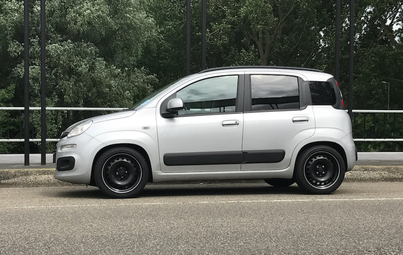

i started with Steel Black 16's on my Panda 169.

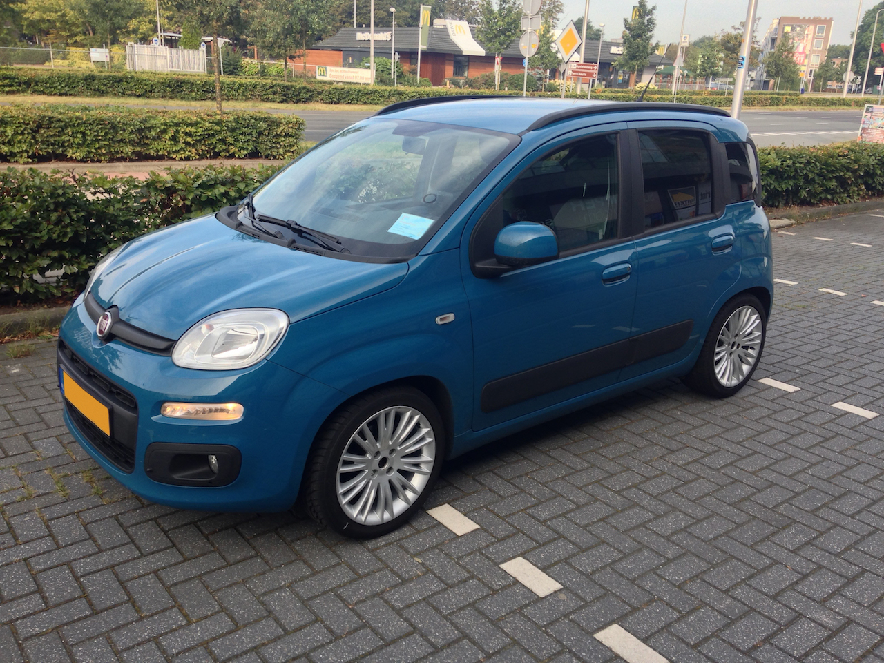

The same steel black wheels move over to my first Panda 85 Lounge Turquoise.

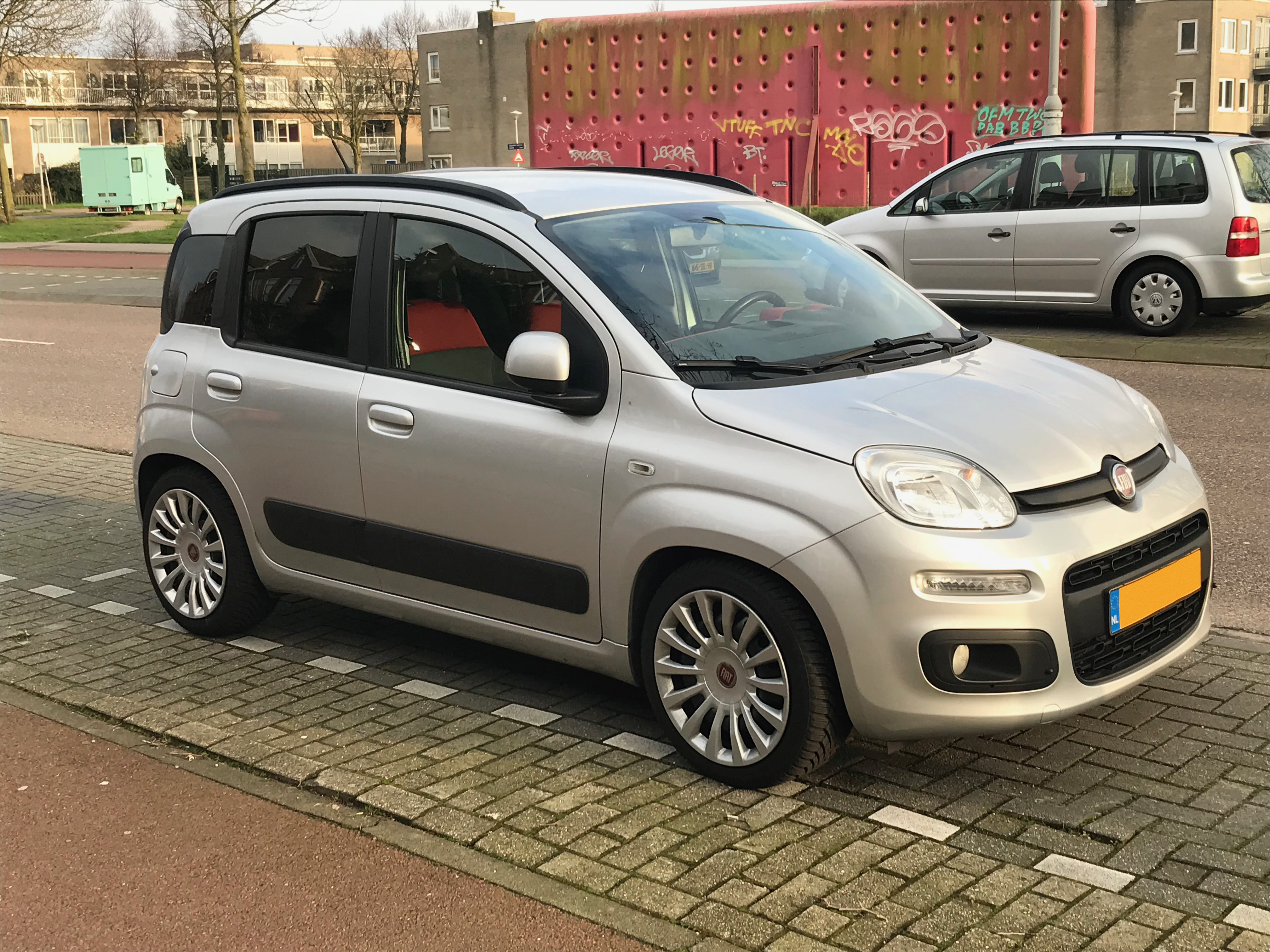

And then move to my present Grigio Argento Panda 85 Lounge.

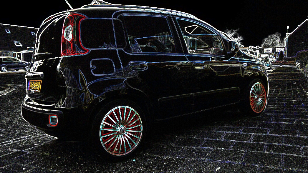

Along the way i had also LM Bravo wheels on both the Turquoise en Grigio Argento Panda 85 Lounge.
Some Pictures.

Cheap and effective. Makes me want to price them up on some website (if I knew where to look)
Does this increase any performance? I wonder if steel rims weigh more than tyres?
Steel 7Jx16 ET31 wheel is 7.5 Kg.
My 215/40R16" and 205/45R16 tires weigh 7.0 Kg.
14.5 Kg per steel wheel-tire, the 7Jx16" ET31 Bravo LM wheels weigh 11 Kg.
Performance wise the Black steel wheels are much better then the heavy LM wheels.
I have 215/40R16" on the front wheels and 205/45R16" at the rear, also lowered with 35mm Novitec Springs, the Panda drives like a Razor. :D
