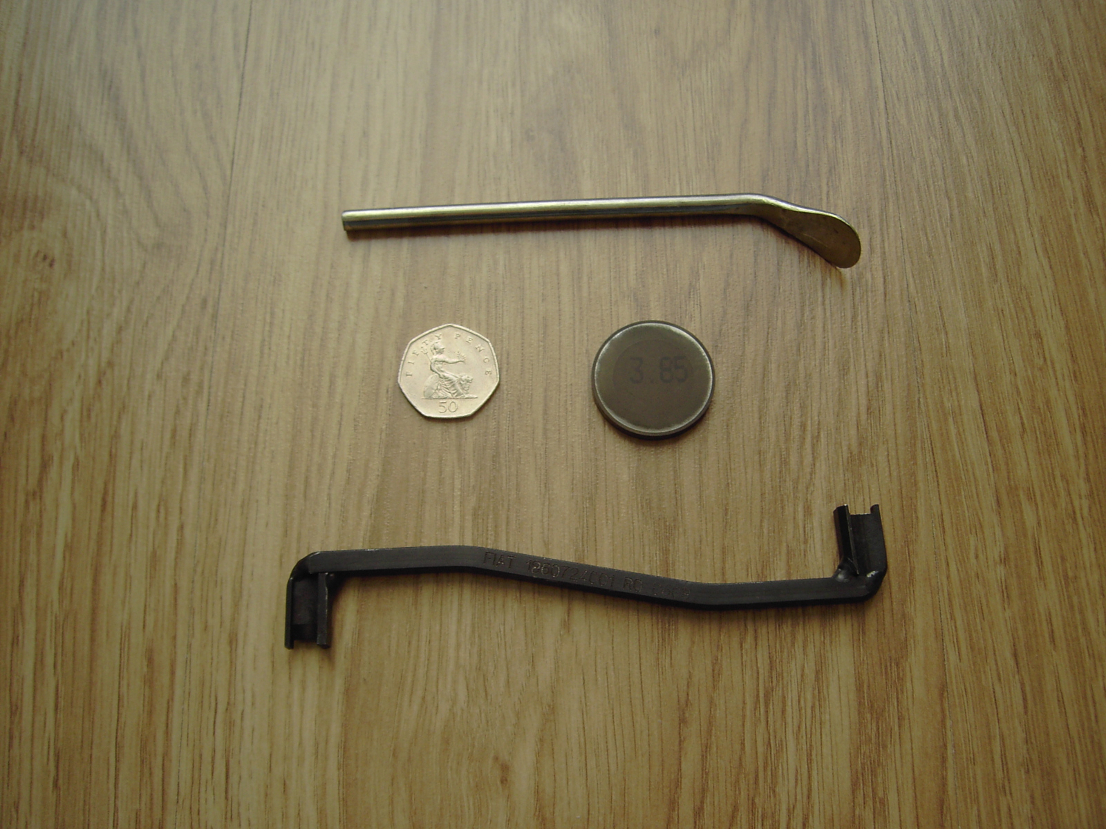

You need to push the buckets down enough to get the shims in and out, so the maximum will be 4.70mm plus about 2mm for the recess in the top of the bucket. It doesn't require much force, a wide tipped bent screwdriver pushed between the back of the cam lobe and top of the old shim will do. I use an old bicycle tyre lever. You will also need something to hold the bucket down whilst removing and refitting the shim.
Disregard the lower tool in this picture, that's for a JTD engine.
