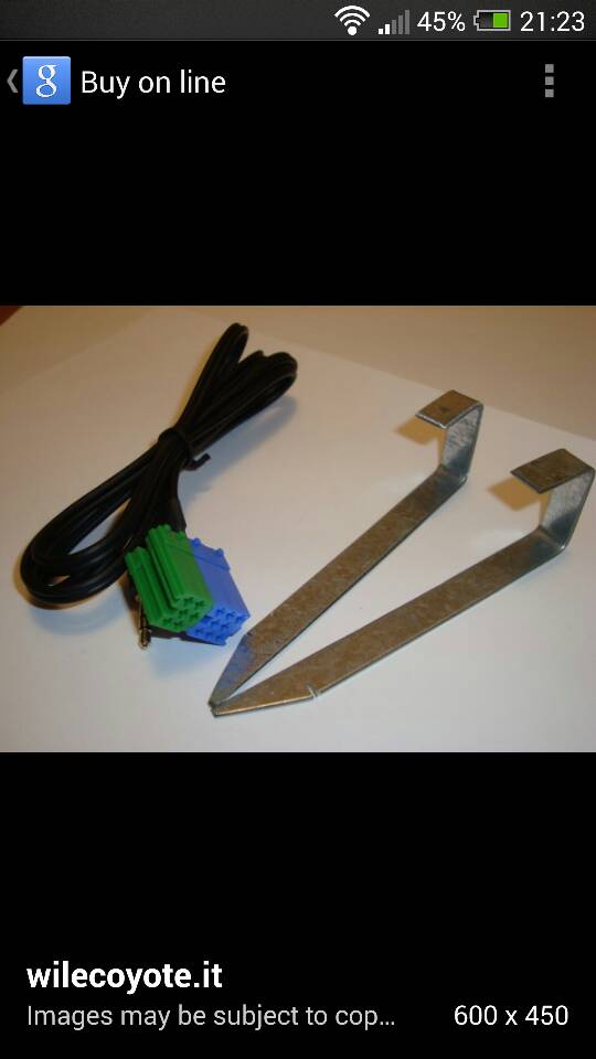

This may sound silly but instead of pulling the stalk to wash front Windows you push it away to wash back one ,and for aux to work u need to buy a cable (20) online and u need keys to remove stereo as it plugs in back (6 eBay) real easy to do hope all these help ,good luck

Could you post up that link for the one you purchased, and how to install it, as I'm new to this car :)

Can I get these keys from a local store? like halfords, I think my sister got some for her Alfa that way.

Hi I might check my lights then ,the stereo removal keys I got from eBay and here's a pic of cable Ul need

There's only one place it can go so u can't go wrong my cable was a long one 2m I think it runs through back of stereo on down back of glove box ,if ur back wiper is going but no water then there's a problem with the pipe somwhere

Is there a part that can be fitted like USB? or 3.5mm Headphone socket, like you would find on a car stereo head. The cable you have must have a 3.5mm connector you put into your device? I would like to have a USB or Headphone socket to plug into, if you can see what I see ;)

I have no idea about other connections I'm afraid the one I have ,as u say the end end is a 3.5 ml headphone jack I plug into my phone for music which is all I really need so as far as others go I don't know
