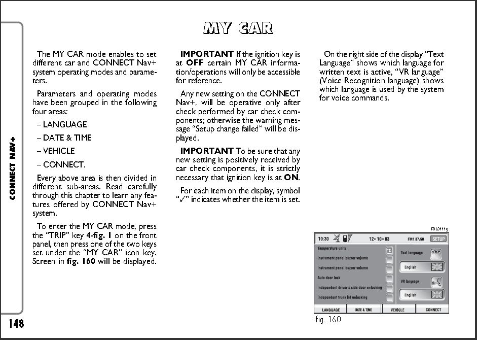

I would like to know how i can access the hidden menu in the Croma
(2005) connect nav+. Everywhere i search the net i find explenations for the stilo. Who can help.

Can someone help me to enter service menu on Fiat Croma?

Hi friends,
Not same because doesn't have SETUP button on Connect Nav+ for Fiat Croma. Other solution?

It seems as though you have to press the " TRIP " button on the Croma Connect Nav units to get to the " SETUP " and " CONNECT " menus.
The setup screen is shown on the picture in post #17 above and in the diagram from the Connect Nav+ owner's handbook below.
If you don't have a handbook, you can download one from here:
https://www.fiatforum.com/downloads.php?do=cat&id=19
