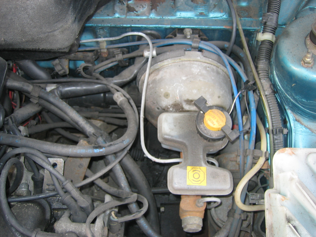

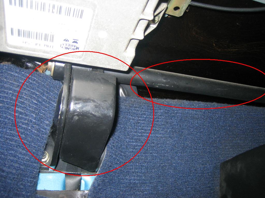

Probably you've got master cylinder on driver site. Pandas with servo's got it on passenger side. There is also bar inside cabil. To change it you need to get whole system from other Panda. In yours one there is no moor to fit servo on driver side. And like MEP said...no big different:(
