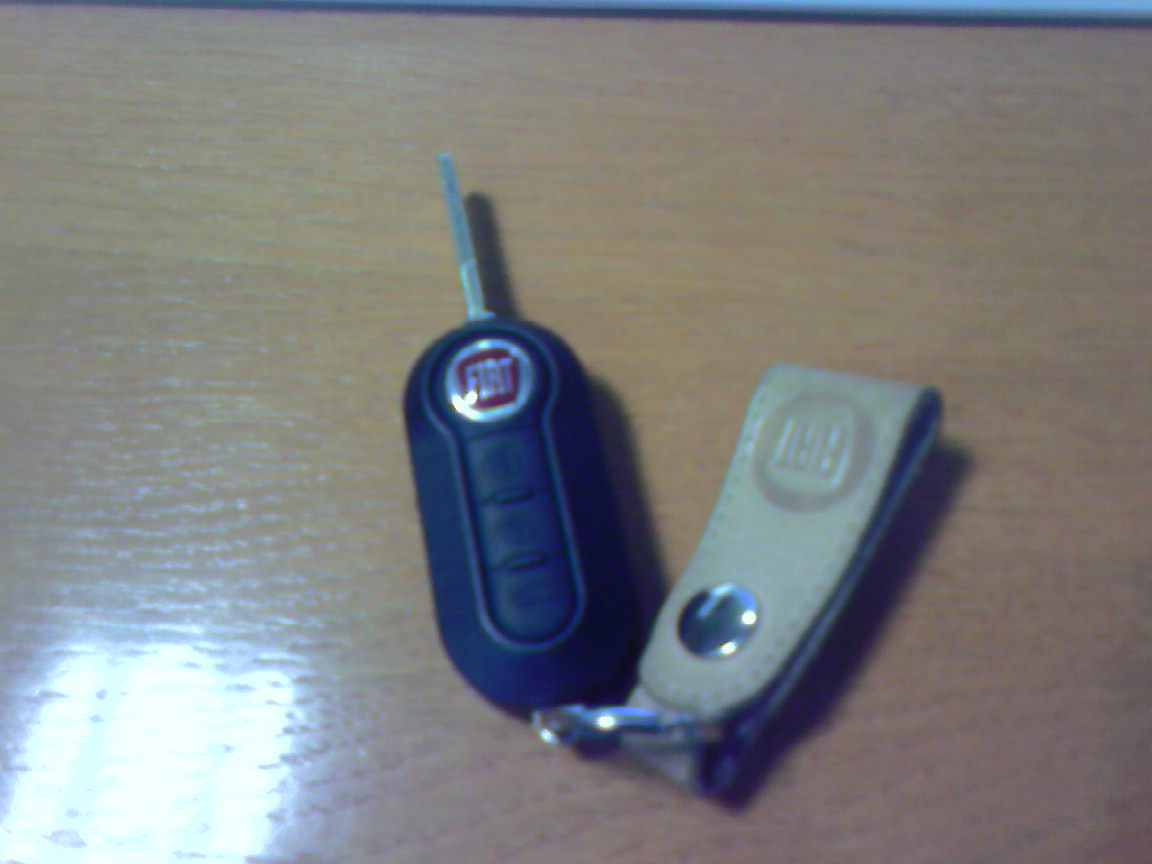

And on top of that I lost my car key currently using the tradional Fiat Spare Key with a Meta Alarm Keyfob so that will be around the £150 mark for a replacement key..
I don't know, but I have two identical keys.

... And know if the new key will be in the style of the Fiat 500 Key as is what you get on buying a brand new bravo now...?
Any new remote keys for your car will be the same as the original. The newer cars with the 500-style keys have a different Body Computer and will not "talk" to the older unit.
