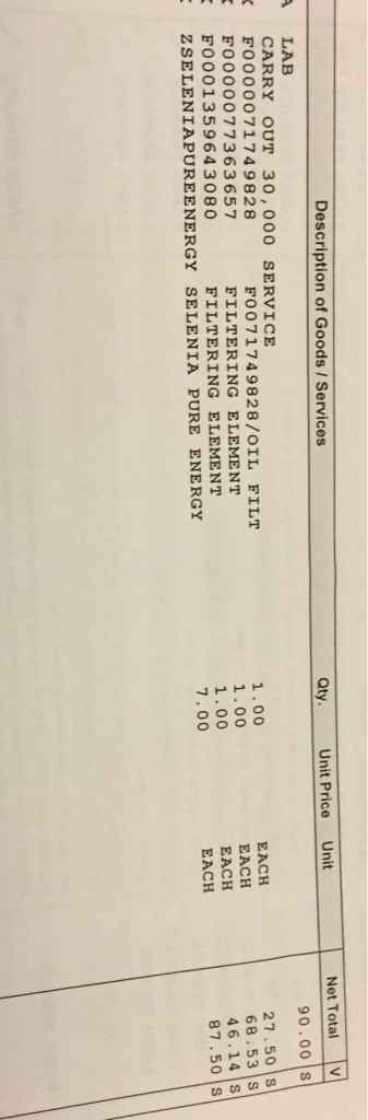

Although this should have been a 180,000 service the numpties did a 30k so had to go back for belts etc, I'm assuming they changed the 3 filter exc pollen, as I don't know which are which
But slightly less than you were quoted mate, ImageUploadedByFIAT Forum1418286518.564640.jpg

Yes they were the prices quoted but I have added the dreaded VAT. The only fiat genuine part I couldnt get was the fuel filter so settled on the one from MANN.
Yes it's always been changed every service, just unsure what they did at that last service! They said when I challenged them on it, the fiat info/schedule they have only goes up to 150,000 miles, so they started at 30k again. But I pointed out the belt changes at 90k and that means a 180k service should have the same as a 90k they said, 'oh yeah'!
