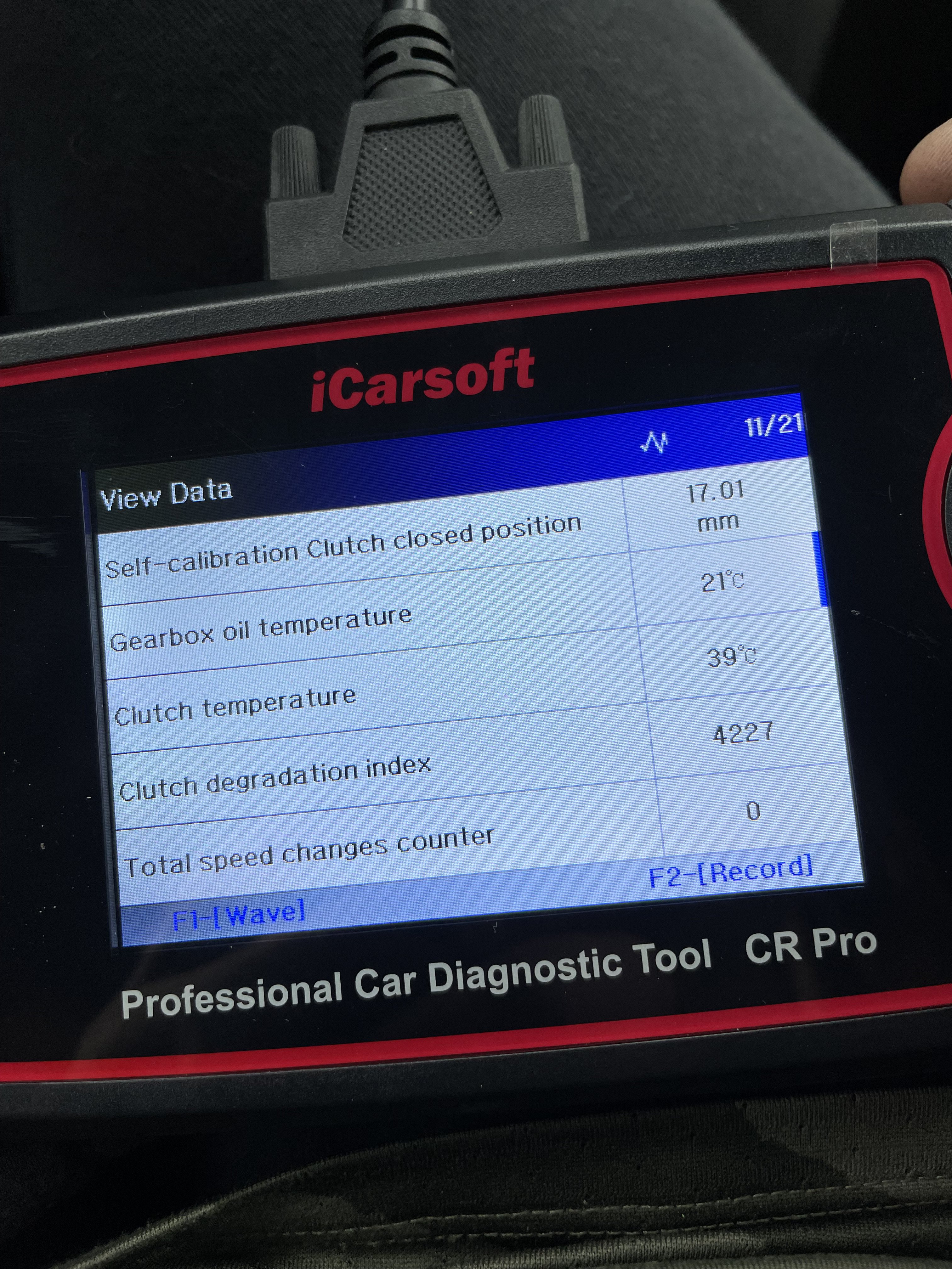

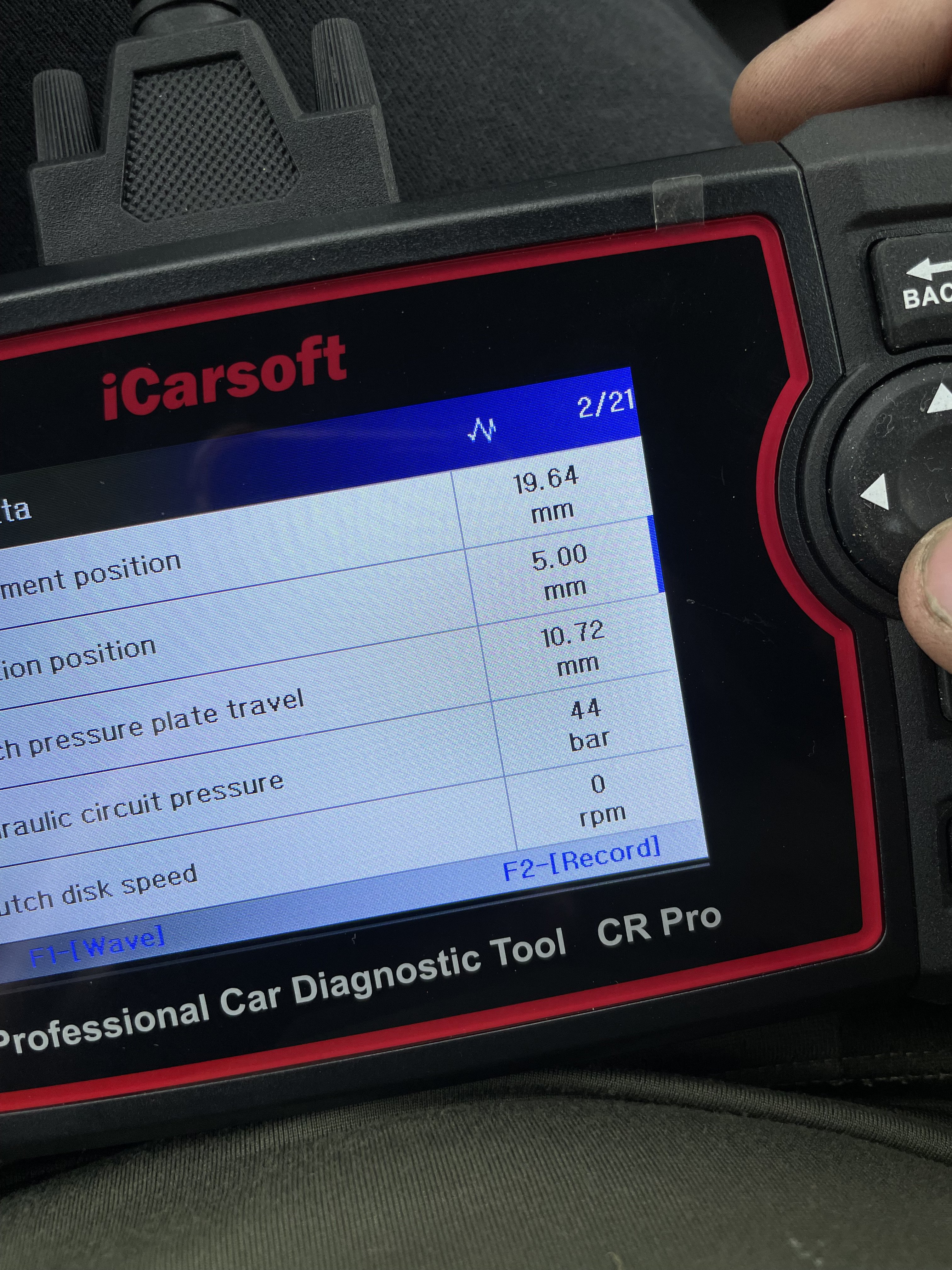

Sorry guys to revive such ancient thread lol but so much information on here which you all seem to have complete the gearbox and clutch calibration
Last year I had issues with the no gears available which I did find was a contact but again this year same issue which was brake switch but it’s time to change all fluids
Transmission oil changed
Clutch fluid bled and changed
Gear box drained
New battery
New earth chassis strap now I’m wanting to carry out the
arnagedon clutch self-calibratuon and gearbox reset or relearn on the multiecuscan can anyone suggest any input in what procedures to carry out that will help please
Here’s some images of some live data I recorded
