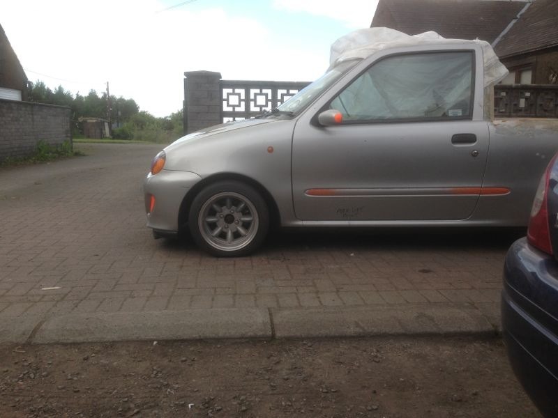

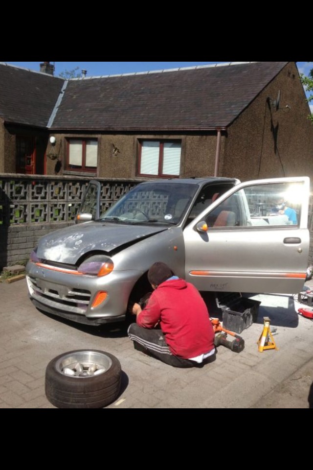

So nice weather ment a good weekend spent with a tin of catty and some styling extra's :)
Coilovers fitted
Ultralite's fitted
Catty work finished
ImageUploadedByFIAT Forum1370208164.614190.jpgImageUploadedByFIAT Forum1370208181.078262.jpg
Going matt black with either orange or baby blue accents, front ultralite's are silver spiked rear are gold spoked, don't have a pic unfortunately, looking to be done completely within a fortnight :)

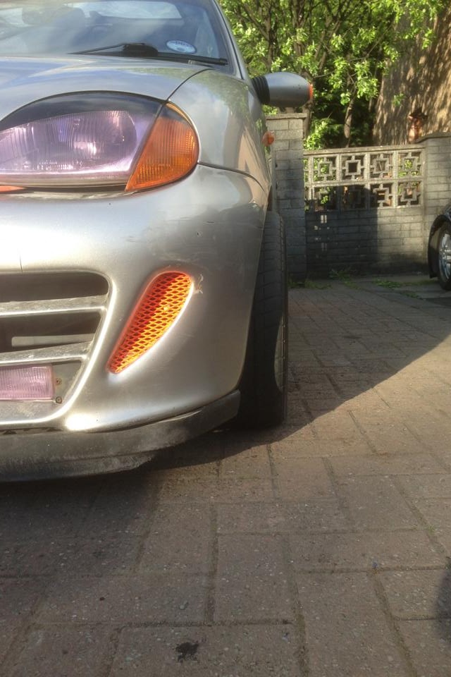

Just another to show how WIDE the ultralite's really are!! 7" is bigger than I thought :p
