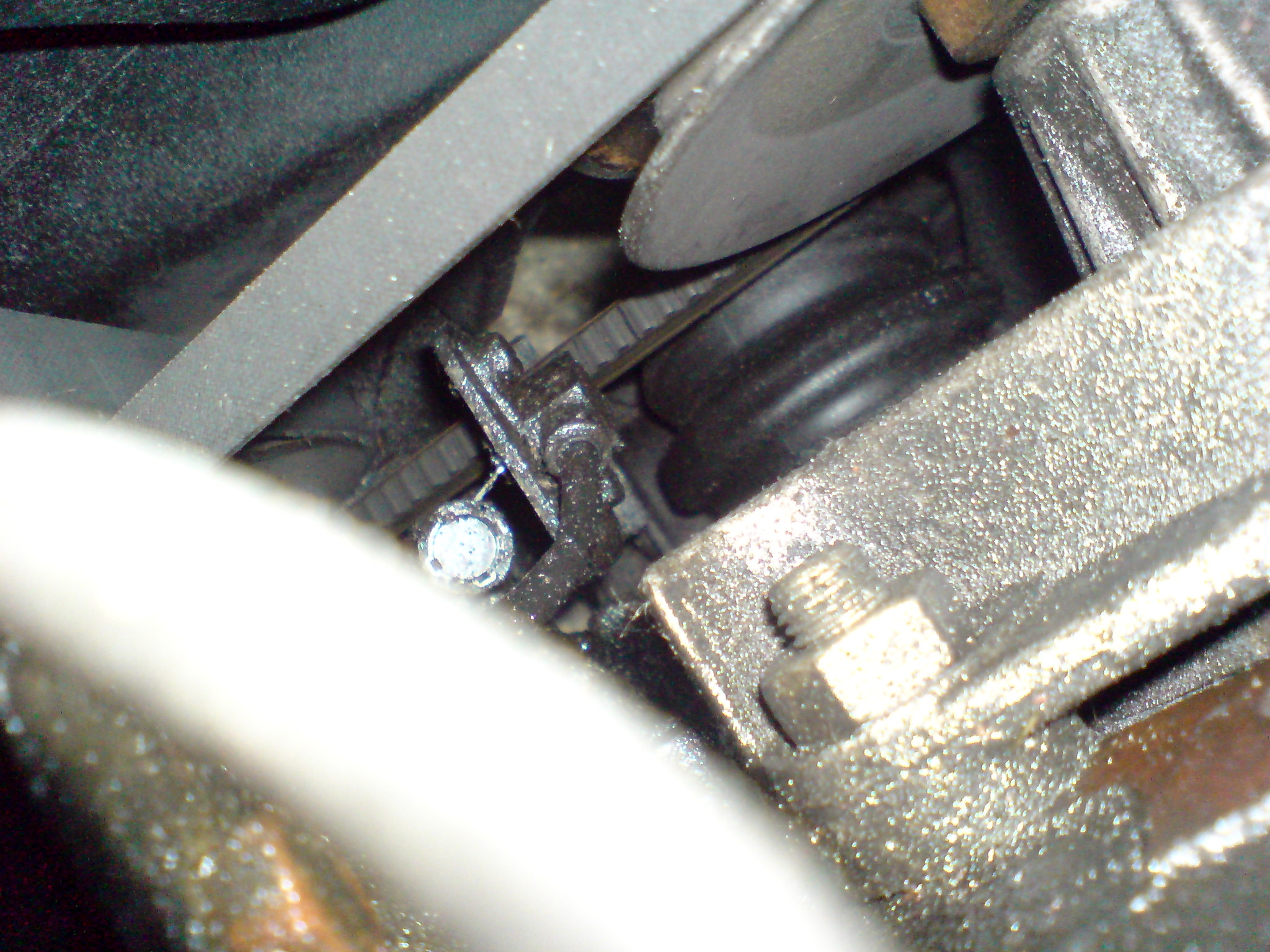

I discovered the problem by daylight. Till now i only had the time to work on the car after sundown. Lookie lookie here, a sheared off cranksensor......
I think the best way is to replace it trough the wheelarch, hence removing the wheel and plastic shielding. Any idea's ? And in Eper two sensors are stated, which is the correct one, or no defference ?
arno
i know theres not alot of room to work on that side of engine, when i changed my water pump i had to undo the 2 engine mounts on that side and lower the engine down on a jack to get into it, nightmare. good luck(y)
