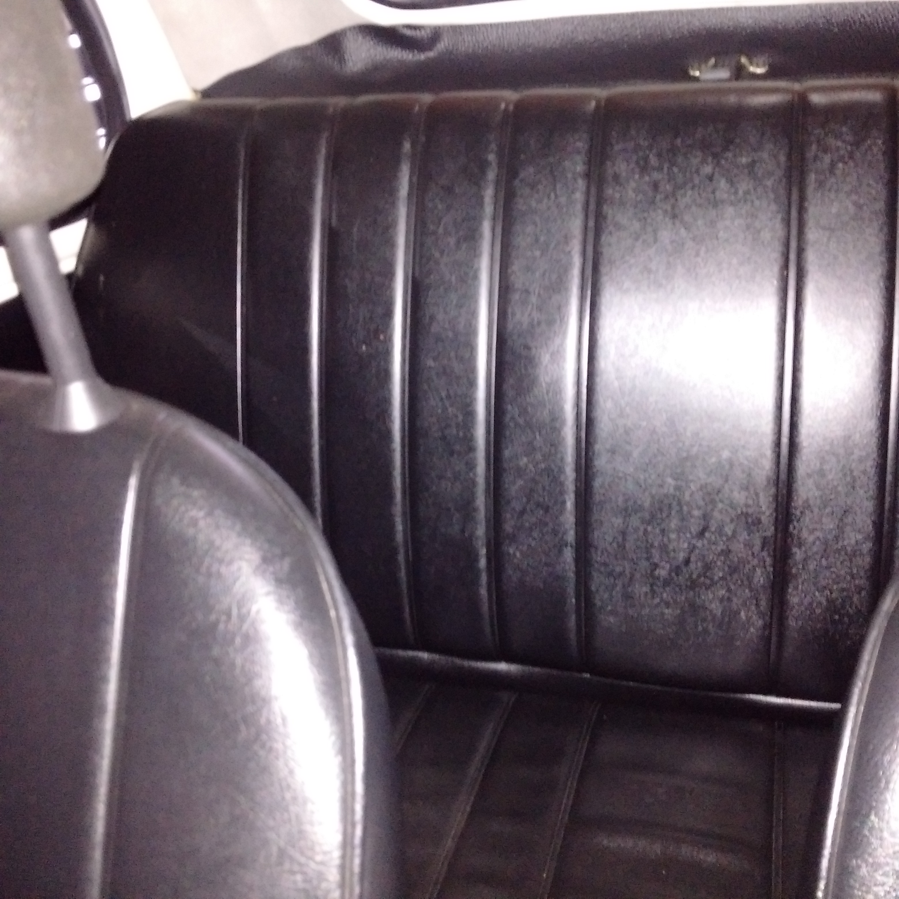

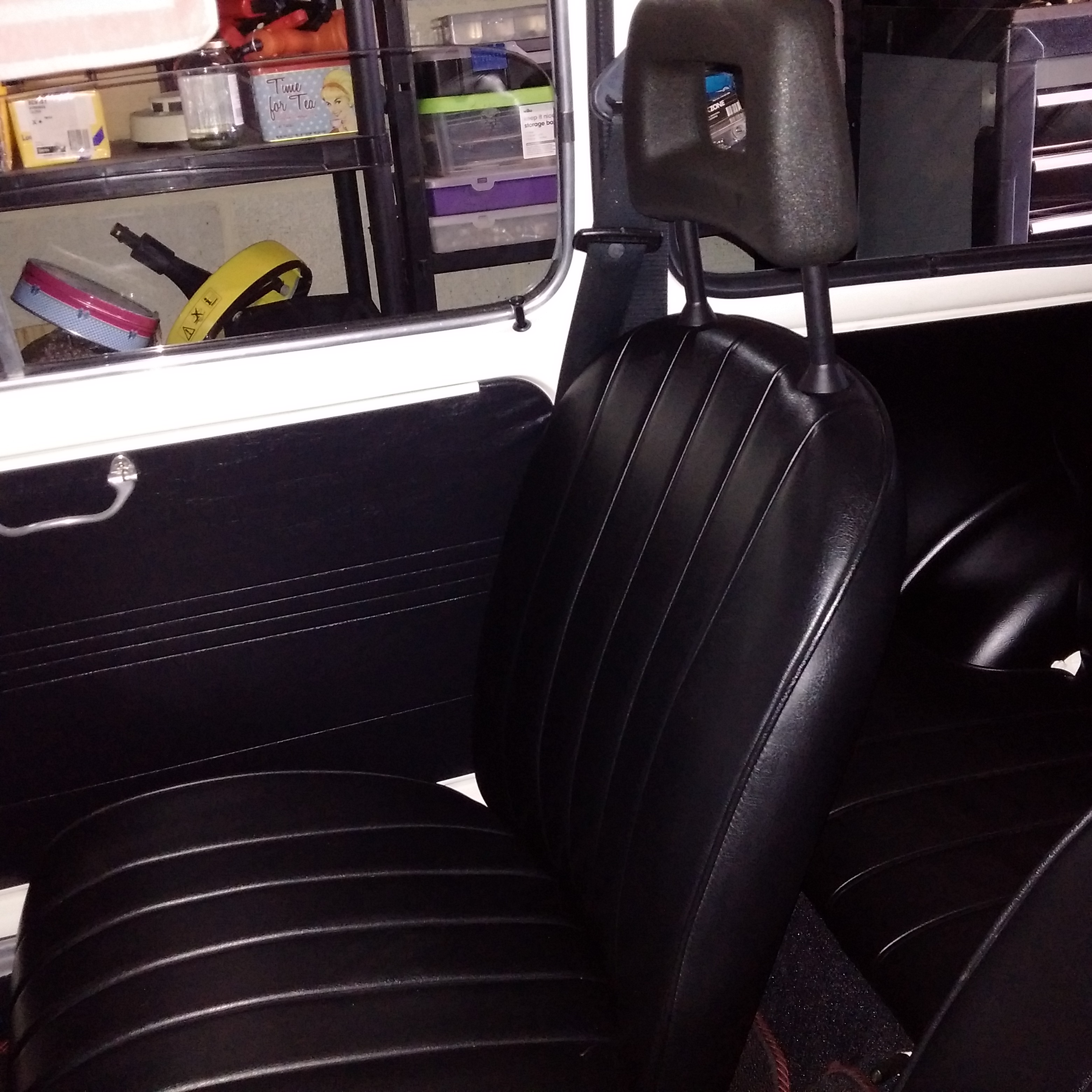

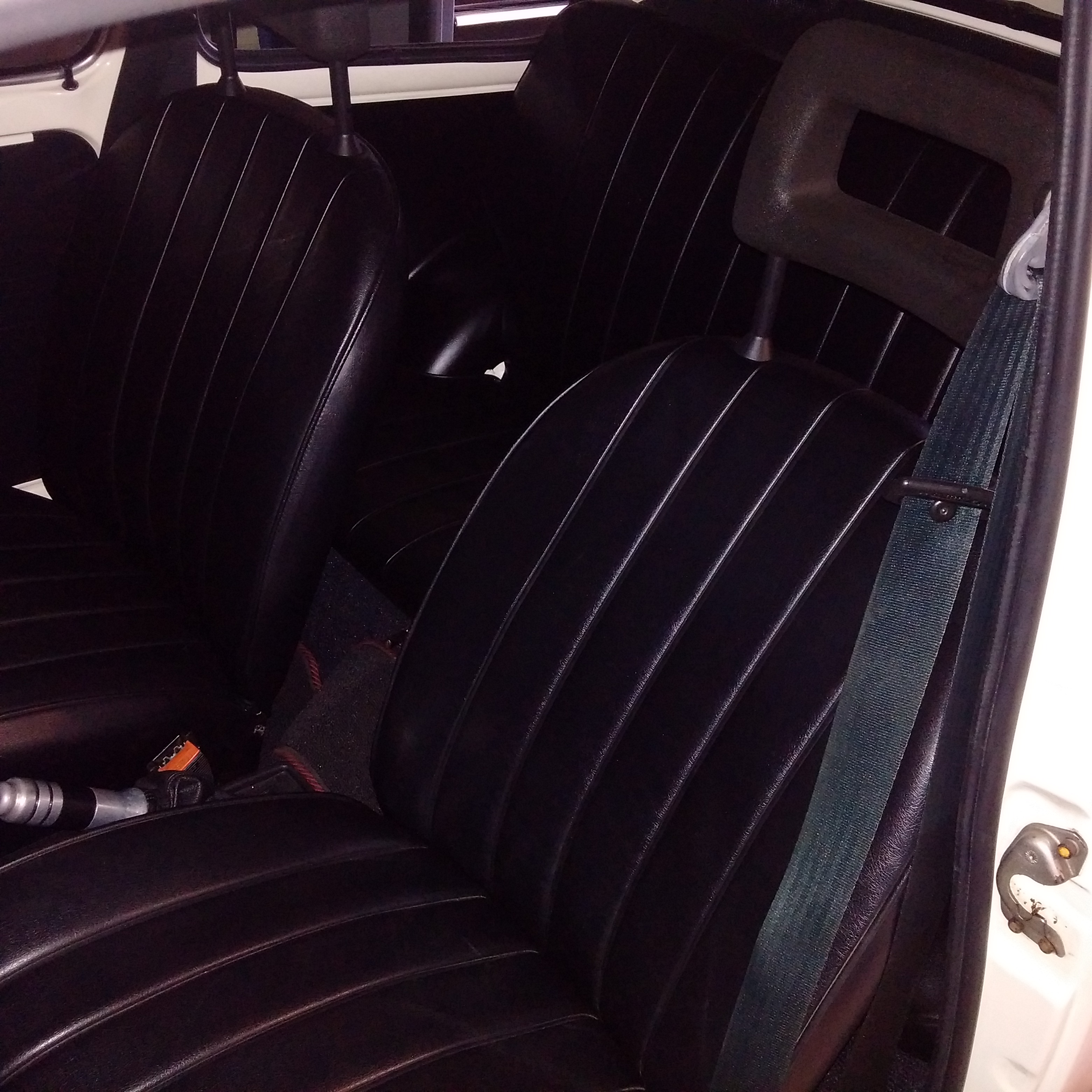

Hello Pete,
My car seating has come complete from a 126 BIS, the front seats are a tight fit on the floor rails but they do fit. The front seats tilt forward with a simple catch at the side of each. The integral head rest / protection can be adjusted up and down to suit and the backrest is adjustable too. hope this helps.
Ian.

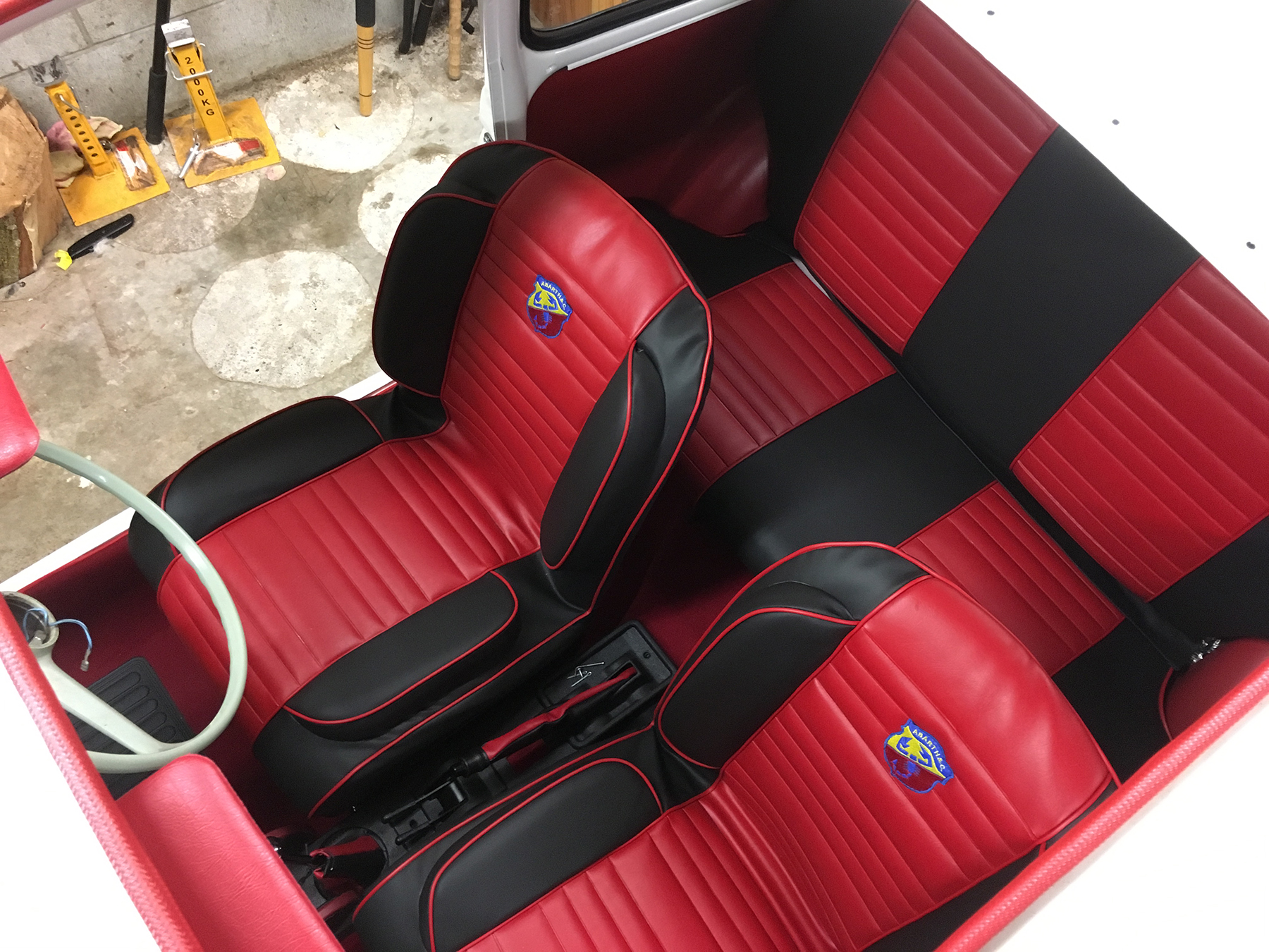

Hi Pete
I went for these covers on the original seats which give a sporty look and are more padded.
Tim

They are super cool - where did you get them / do they come in other colours?
It was a while ago and I thought it was either Van Der Laan or Ricambio but I can't find them on those sites now.
However, Mr Fiat has them in more colour options than I've seen before. A bit more expensive I think. Try here:http://mrfiat.com/italian/fiat/fiat-500/upholstery.html
