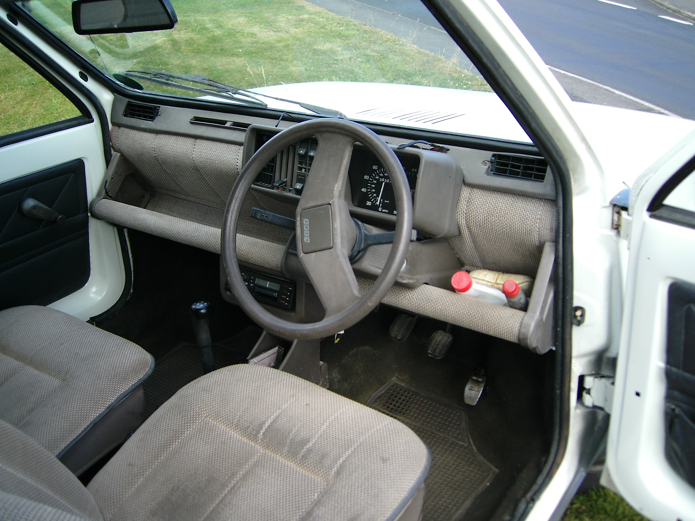

Has anyone got a pic of the heater to screen vents on a MK1. The plastic inserts I have don't seem to fit.............
Nooo, sorry I missed this. Not sure which bit you are talking of though. Below are some pictures of the interiors (with brown plastic trim on the 4x4 and with the vents exposed on the panda 45) but let me know if this does not show it clearly. Thinking you might mean the actual heater box assembly but I don't think I have a picture of this. I do have one out of the car somewhere in the garage though so could take some pics later. This was from a mk1 4x4 as well.

Hi Si. Thanks for posting. In my boxes of many things I have 2 plastic screen vents which look like they clip into something but the are too short to cover the metal dash holes.
I have 2 full width (dash) covers. How do these work. What are they off?

Ok got ya now ;) well I think leave that trim off. The SEAT wouldn't have had it anyway probably and bare metal looks way cooler anyway :devil:
As Kev says it's mk2 panda trim. I'd have thought it would just screw on using the same screw holes across all pandas though (even the budget early panda's had the holes there for it but with a bung put in to tidy it up a bit).
