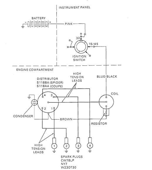

Hi Tom, I attached an image of the ignition connection from the electrical service manual I found. Maybe that will help?
