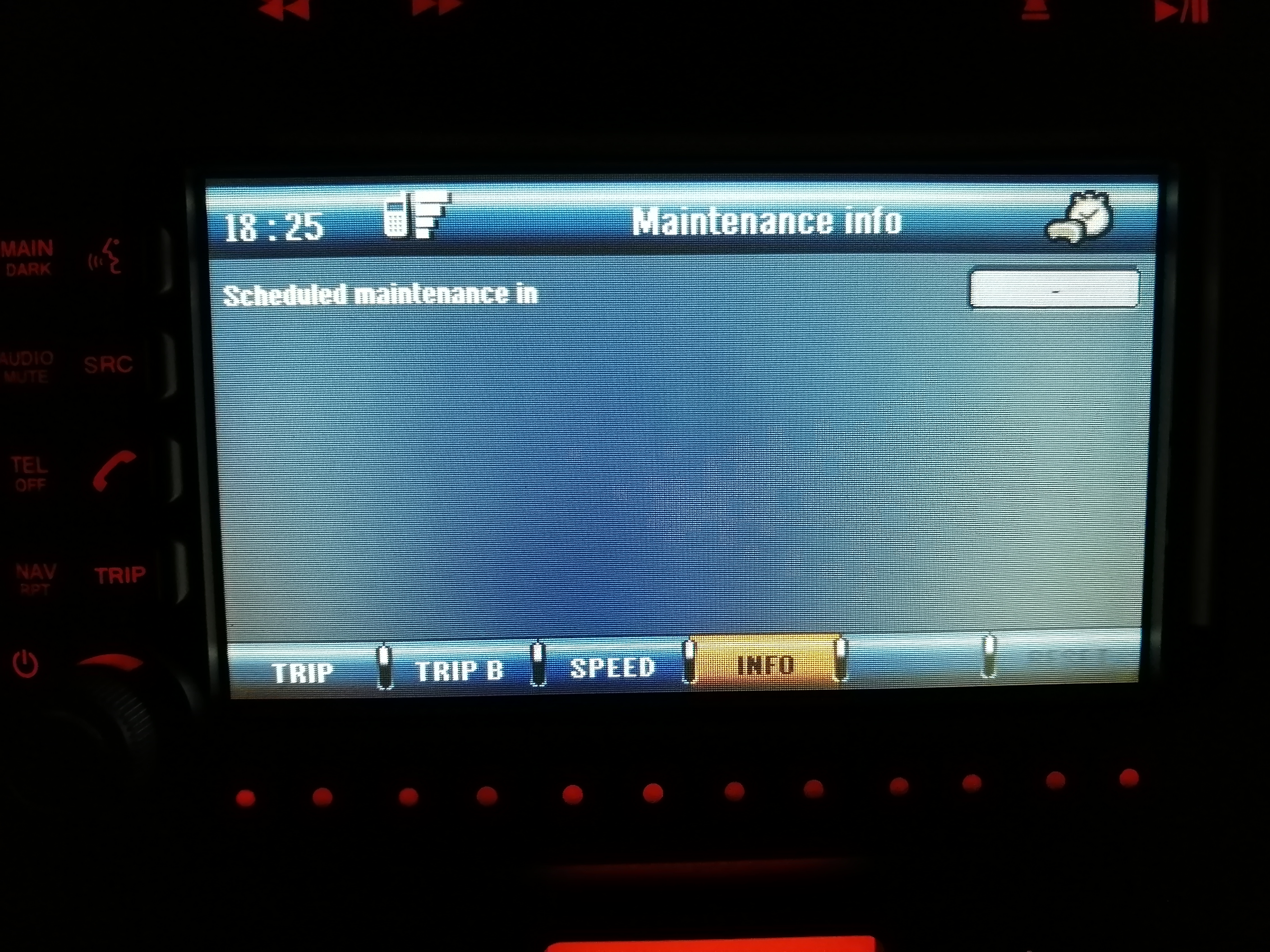

Hi All! Sorry for my english... I changed the engine oil, and after I reseted the service interval and the oil changing interval with AlfaOBD, the "scheduled maintenance in" deleted out from Connect Nav display (not 30000, just -). It used to work perfectly... Please help. Thanks. View attachment IMG_20220204_182416.jpg
The Croma came with 9 Service Coupons. At each Service Reset the coupon count is reduced. Also note that an Oil Reset does not affect the service coupons.
After the 9 service reset the Service System is disabled which is what I think yo are seeing.
In MES, and probably AlfaOBD, you can set the Coupon Count back to 9 or more. This should restore your service interval information and warnings.
It working, but just without ignition. When I switch on the ConnectNav-without ignition key-, the km value is visible.
