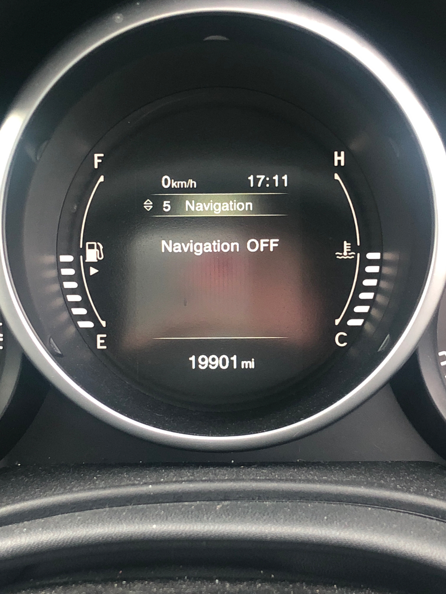

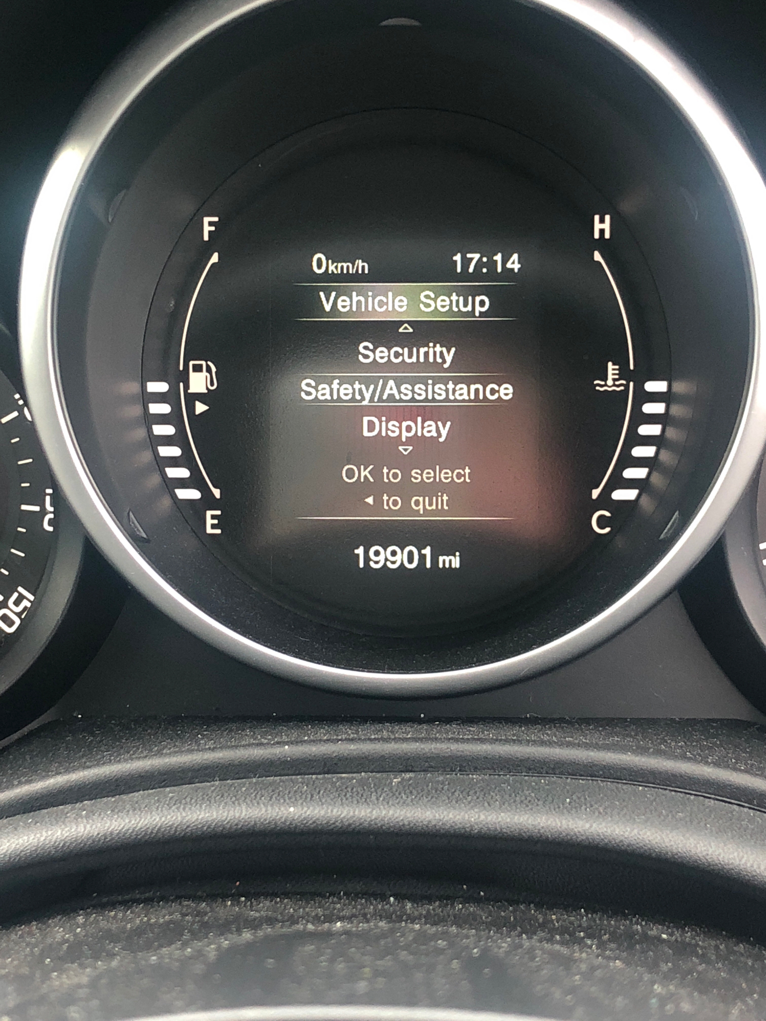

Ok soooo sat nav 5” works real well ‘now’ however when I scroll the menu on the steering wheel to the navigation part it says OFF. Is there any way I can switch that ON so that Mac can tell me where I’m going when I’ve got the stereo on

I assume your are on:
Menu 7 Vechicle Setup
See Navigation
Press OK and you will see On and Off with one ticked. Use Up/Down button to change selecttion then press OK.

This is all I have in menu 7 and in menu 5 this is it View attachment 1
You will only see directions appearing in that menu when set to view on the central dial when you have a Route planned/setup in the Nav. And as per my other thread - as per your image - when you are following directions with that view displayed you will need to convert your speed to KMH in your head - as per top left of your photo - it does not show in MPH?!?
