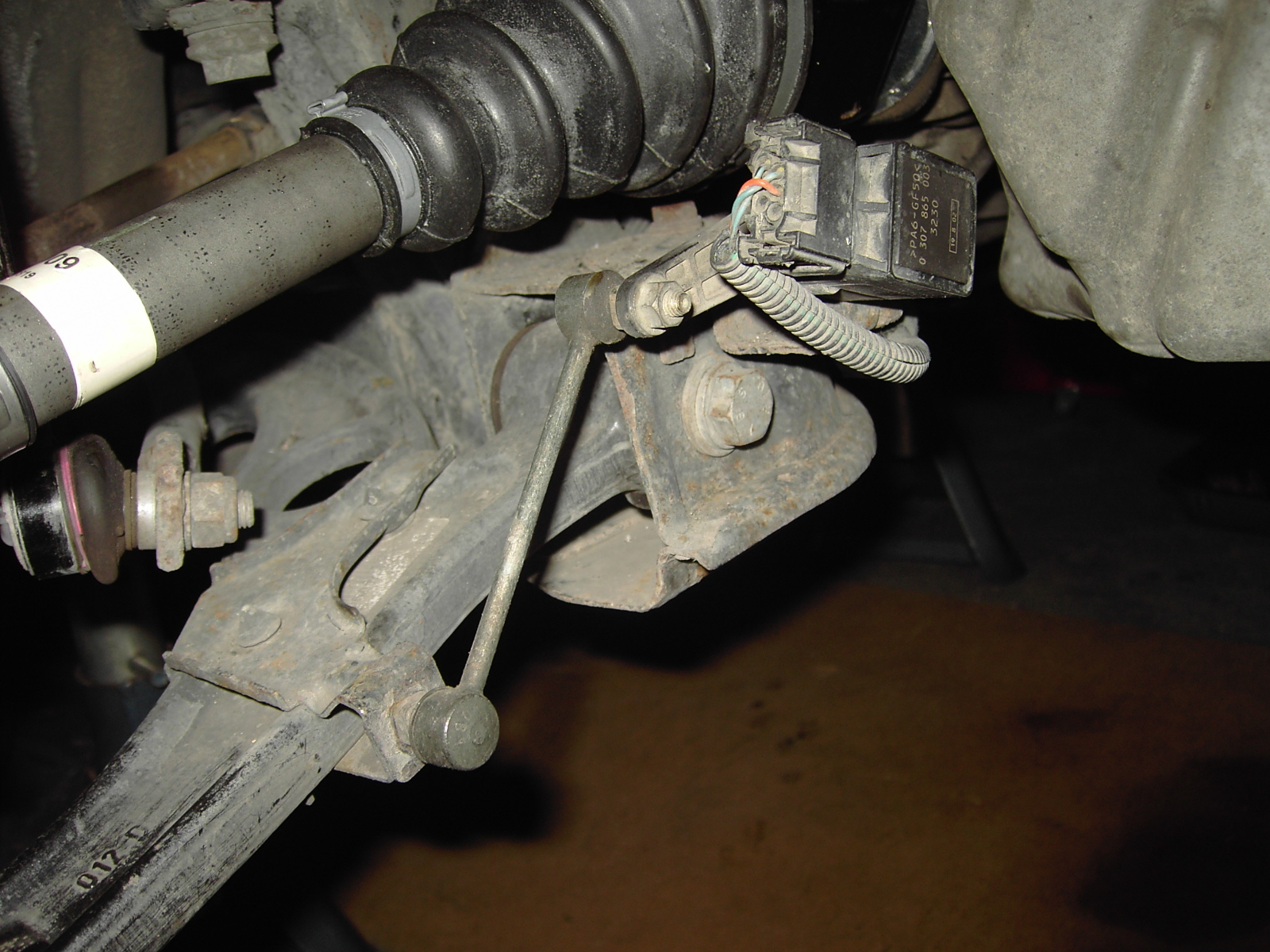

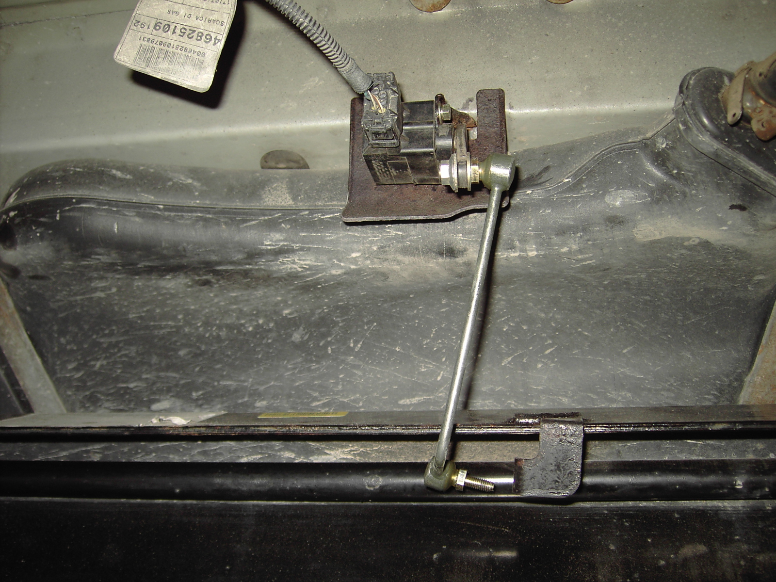

Did you also install the leveling sensor, i think it's attached to the rear suspension frame.
This is second hand info I'm telling you, so don't bite my head off.
There should be one sensor on the rear axle and one on the front right lower suspension arm. From the MES screen above, it looks like it is reading voltages from both sensors.
To calibrate the system, you will need an interface or adaptor lead that connects to pin 12 of the OBD socket.

Yes I had install the two adjuster and made the calibration. The whole system is working fine. So that's why I didn't understand that the Can info not shows the self leveleling option and the proxy alightment also. When the system was installed the speedo didn't flashed. This is what happened to my friend with his Croma. Maybe to see this option need to turn on with an Examiner?

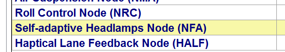

This is the list of NODEs I have:
If it wouldn't be connected to the CAN network then you would have no idea of any error.
The problem is : when we connected everything the BC didn't needed proxy, and the speedo didn't flashed. But I can connect to the headlamps, and they using K-line so the a BC connection is OK. Thats why I thinking that to enable the NFA is needed Examiner.
Do a proxy alignment.
I think it only flashes if a node is removed ... might not flash if you add a node... but it would need the proxy alignment in order to use the new node.
