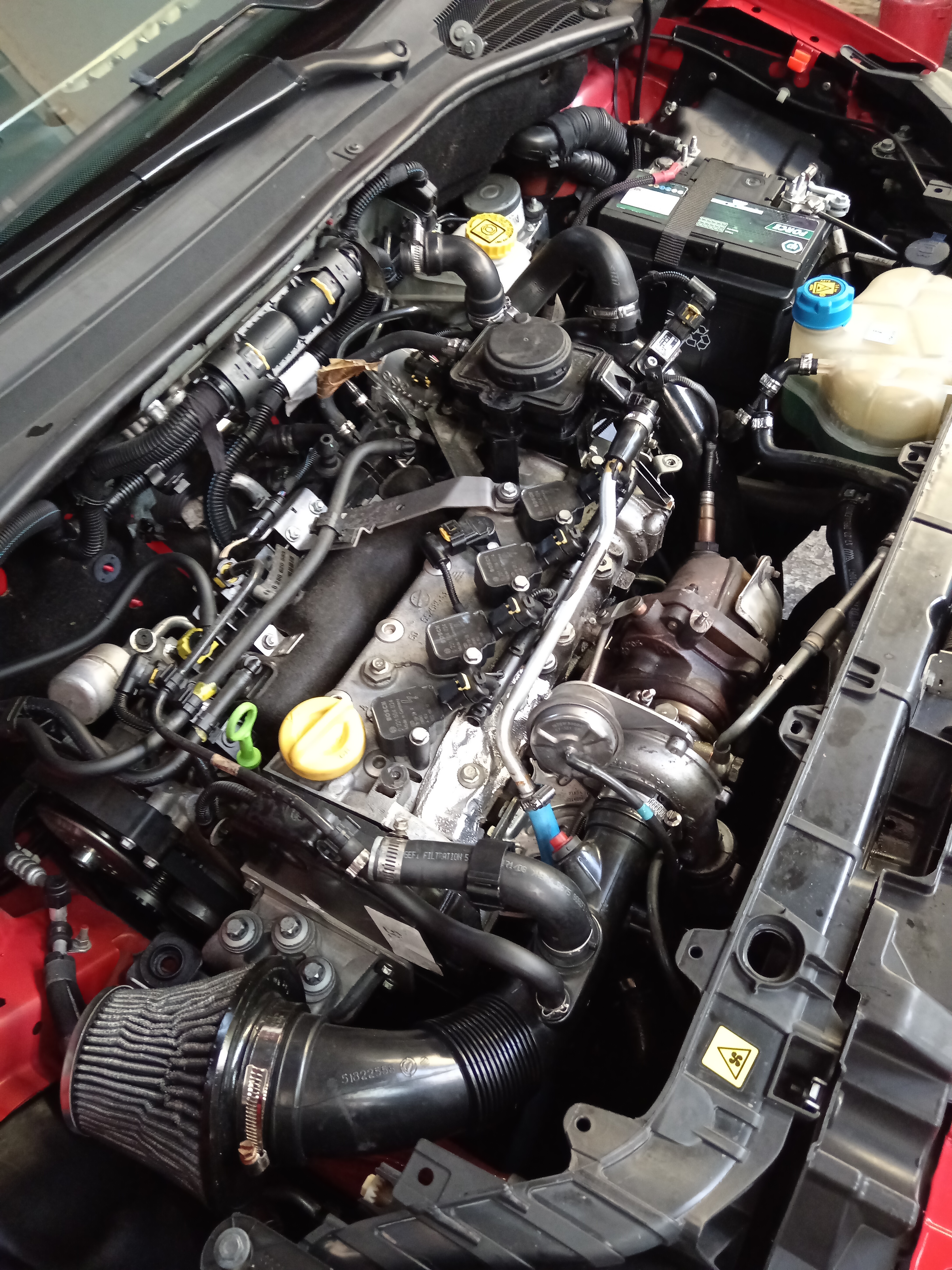

Newbie on the forum, from Madrid ATM with a 08' tjet 120 Sport.
I've recently swapped my turbo to a VL36 with a lighter billet performance comp wheel (stock vl36 size), APE rear silencer, gutted cat, and removed middle muffler.
Also added a secondary O2 sensor spacer to avoid DTCs. Have to do a remap yet deleting the cat.
The car runs like sh*te. Terrible lag, turbo threshold is like at 3500rpm, no torque, boost is of course within the stock map at High rom only and it's hella terrible to drive. Fuel consumption is also higher.
Anyone could help me here? Is it just the lack of a remap? Car ran great before doing all that job together. And I've just swapped the turbocharger's chra with the vl36 one (also it's comp housing) and reusing the exh housing.
Some pics are attached..also a picture of the vacuum hoses to the n75 solenoid.
Thanks in advance!

You definitely should get it remapped as the stock ECU does not know that you replaced the turbo with a slightly bigger one, and especially that you gutted the cat. Any updates?

Get a cat and test if the car works ok with it, I think that's the main reason the car runs poorly. The lambda sensor might be giving weird readings to the ECU because of the gutted cat.
