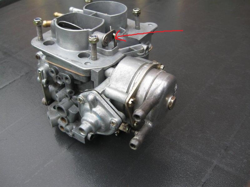

Hi Jimbro i am a bit confused when you say [choke arm poking into the autochoke thermostat housing] is this what you mean
Close, but sadly no cigar this time. That is (ultimately) the other end of the choke arm. If you spun the carb around 90 degrees clockwise you'd see the bit I'm talking about.
The thermostat housing is the round lump on the side of the carb (nearest the camera in your picture). It splits into two parts, the coolant housing (with two pipe connectors) is the outermost piece. The spring and control cam is the inner part.
The choke control arm fits into a small apperture in the side of the inner part of the thermostat and rests against the control cam. The cam itself is stepped so as it warms (and rotates) the arm can slide in but if it were to cool the cam will jam against the arm until the throttle is opened, at which point the arm is pulled out, allowing the cam to rotate (this is what has to happen when you prime the throttle from cold).
You can just see the arm in this picture, you can also see the slotted head and thread on the arm that allows adjustment. Thanks to midwest-bayless for providing the picture!
