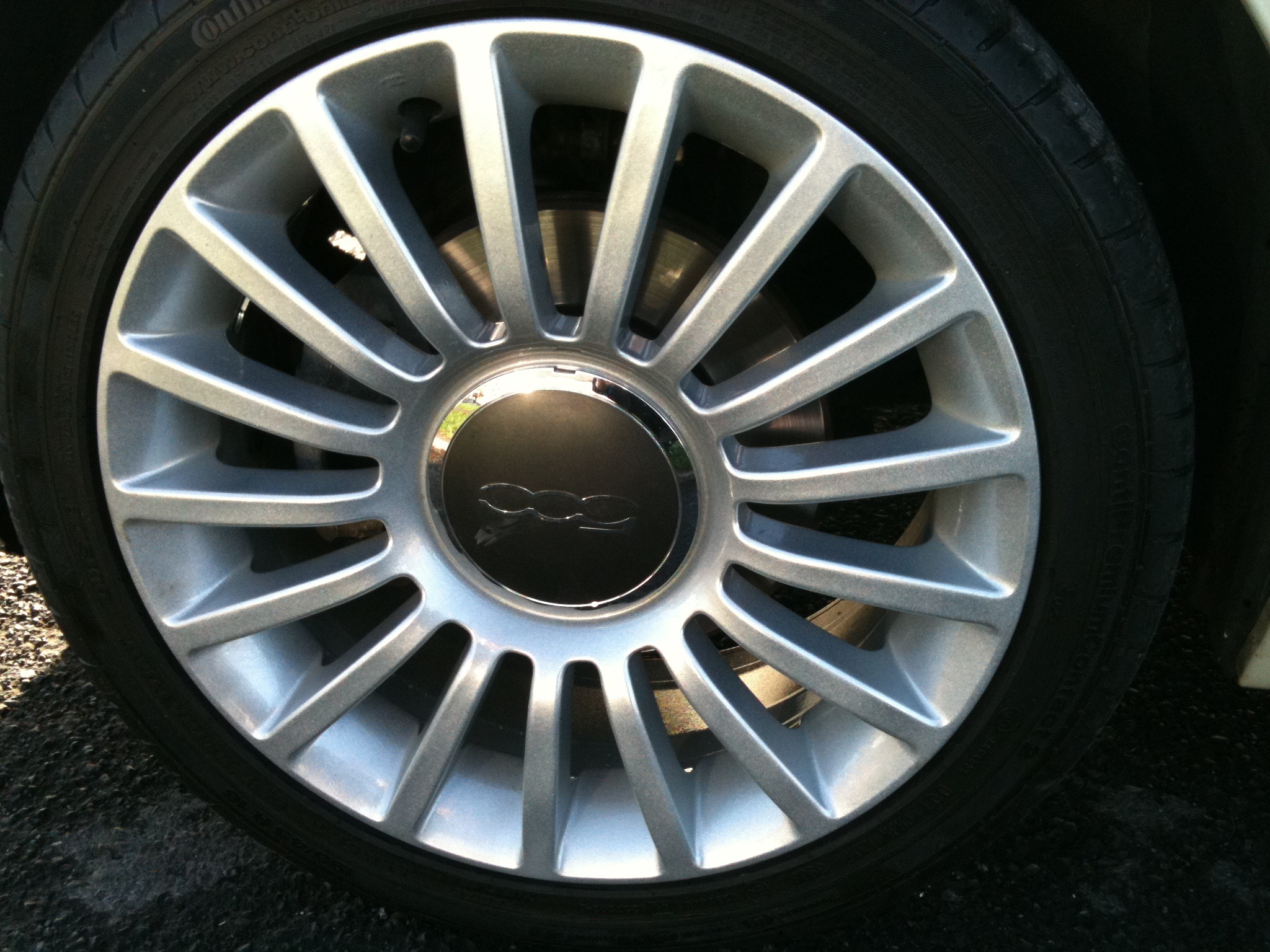

Here are the tyres. Note the H & V on the back. Patterns are fairly similar. Some brands on the same axle. Understand that the V rated is a stronger tyre and aside from the exceeding the maximum speed it is supposed to 'cope' with more 'aggressive' driving. I would guess that they are slightly heavier.
Got a price of 2 stock Continental Contact 2s in 195/55 x 16. 'Advance tyres' eventually budged on the €150 price to €135 and I was been pawned off that the H rating was fine and I should have no issues. 2 other tyre outfits did the exact same thing on Bridgestone ER300 again with Minerva at €80 on a H rated.

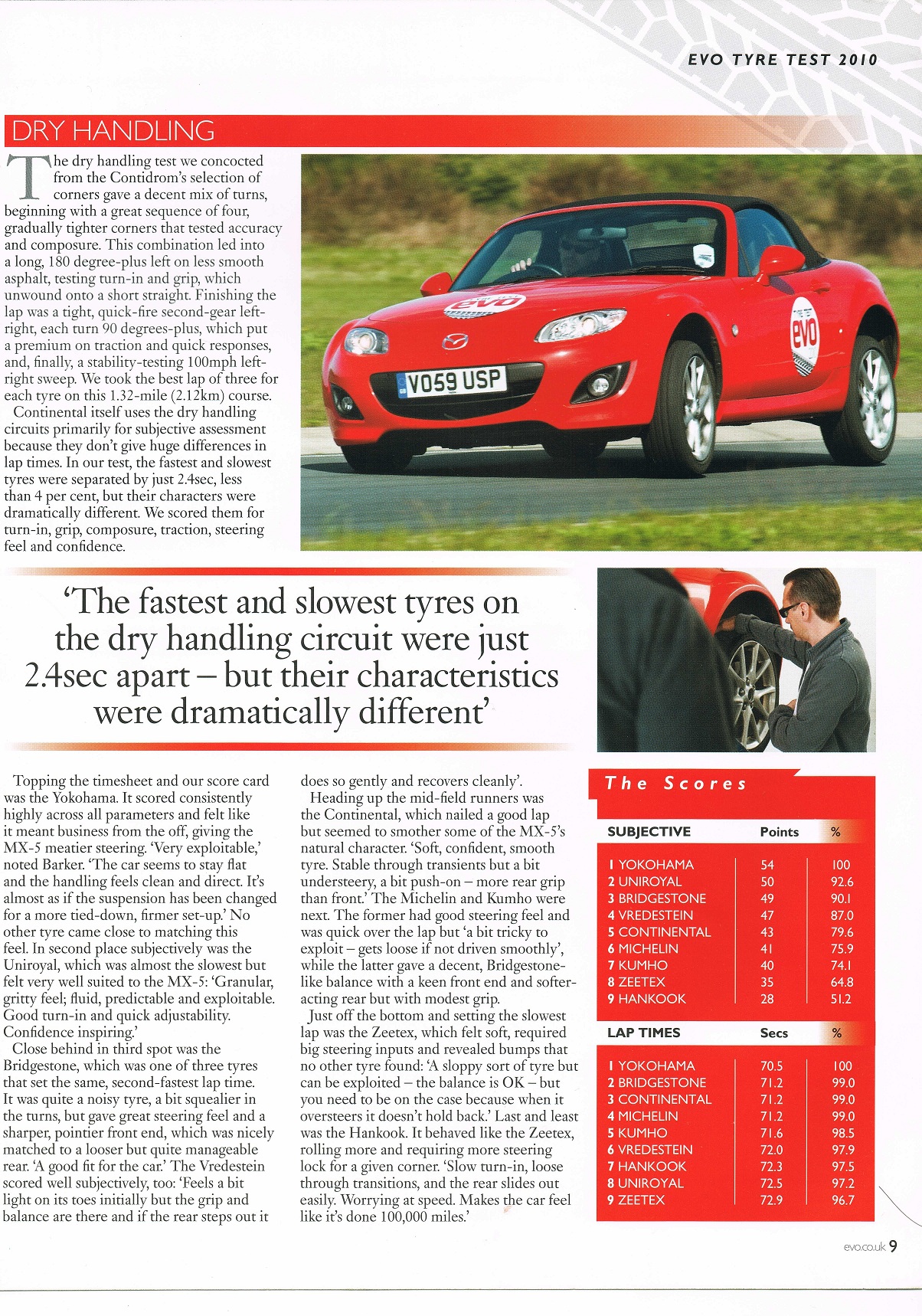

They can be a hugh variation in a particular tyre across sizes. If you look at the EVO test report below
http://www.tyremen.co.uk/help-and-advice/evo-summer-test-2010.aspx

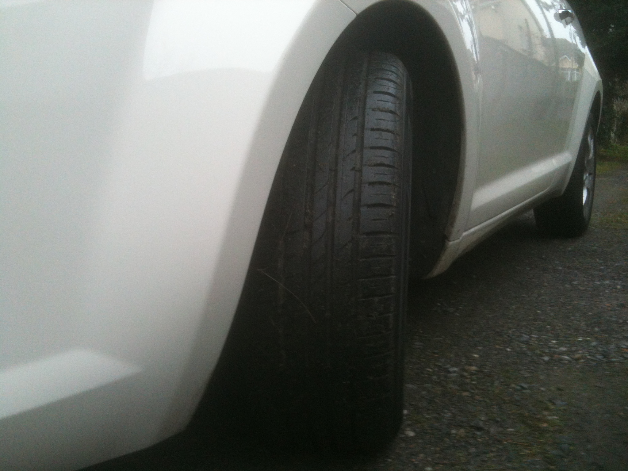

the Hankook came 2nd (on an 18inch) in 2012 and 2nd last (on 17 inch) in 2011. I have a copy of the 'EVO tyre test 2010' and the Hankook (ok a different model the Ventus V12 EVO) also came 2nd last (17s). In the dry handling section it commented that having them on the car made it feel like it had done 100K miles and was subjectively the worse in that section.
The tyre fitters didn't rate them and commented that it's only a 'Far eastern tyre'. Realise that they are doing well on the 'big' sizes and are getting fitted by the top names.
I reckon the key problem is that the 16s are too small for the car and it needs 17s. The Bravos are 'running' 225/55 in the 16s and the extra footprint is probably making all the difference.
Prices here for the Contis 2 in V rated are €175 with a week lead time and €150 for the H which I wouldn't risk now in size 195/55x16. Eirtyres are showing €108 but no availability at the moment. No Conti 3 available yet. Understand that Conti have changed the compounds for longer tyre life some remarking that they didn't last.
As an interim 'fix' I'm of 2 minds to switch the Michelins to the front to see if it makes any difference.

Here is one test that I could come across on the Prime 2...
http://www.tyrereviews.co.uk/Article/2011-Finnish-ECO-Touring-Tyre-Test.htm
and the Prime2 came in at a miserable 9th along with the Linglong, etc.
Looking back on the service history these Prime2's were fitted only 6 months ago (done 4K miles) at a cost of €90+13.5% vat which was in Irish terms 'cheap'. So they were 'value for money' so I will admit to being a bit harsh on saying that they are 'crap'.;)
The Continental Premium Contact 2s that I had on the Fat 500 were so good it had highlighted the 'Touring nature' of the Hankook Prime 2 tyre.
I have included some relevant articles on rolling resistance which the Hankook are generally good at but in the case of this particular variant it gets the thumbs down on from the 'Finnish' review.
1st: Continental Premium Contact 2
Total: 103.5 / Dry: 29 / Wet: 39 / Rolling Resistance: 8 / Comfort: 9 / Noise: 9 / Overall: 9.5
Positive: Grip and driveability in both the wet and dry
Negative: None mentioned
Overall: The Continental Premium Contact 2 is a convincing tyre, winning in almost every test. Best dry and wet grip and great handling
9th: Hankook Ventus Prime2
Total: 81.4 / Dry: 23 / Wet: 29 / Rolling Resistance: 6 / Comfort: 8 / Noise: 8 / Overall: 7.4
Positive: Excellent aquaplaning resistance
Negative: Wet braking
Overall: The Hankook Ventus Prime 2 is let down by its wet braking and high rolling resistance. Its aquaplaning resistance is excellent and dry driveability good.

I must do the swap and see if it makes any difference but I'm leaning towards getting a new set of Contis. It's a pity that the new Contis 3 are not available in 195/55x16 size.
