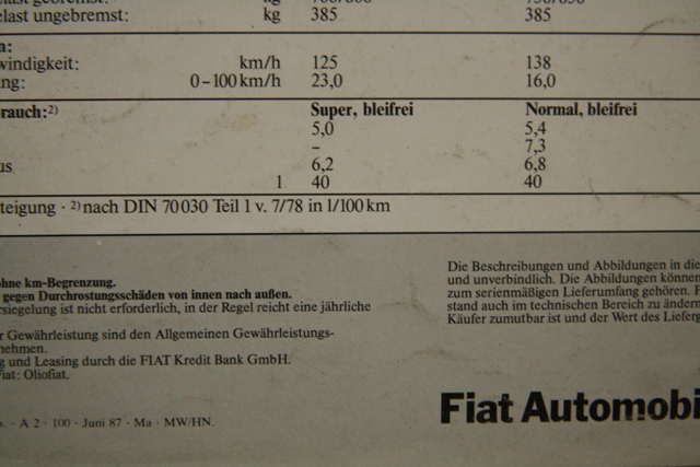

IMHO all FIRE engines were designed to run on unleaded. You could also use leaded, unless it was equipped with catalyst. German brochure from June 1987 says "bleifrei" which means "unleaded". I doubt that Italians made two versions if the same engine, first strictly for leaded fuel, second for unleaded.
Sutjeska

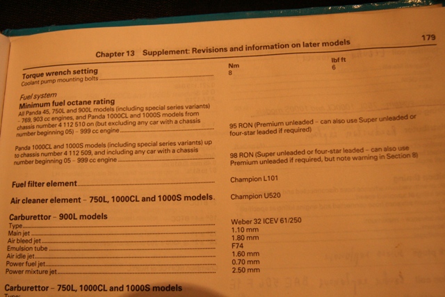

And let's see what good old Mr. Haynes says about that;)
Sutjeska

I agree with most of the very useful information from Petel, though it IS possible to run some 1986 models of the 999cc FIRE on unleaded. I have a 1986 Uno with the 999cc FIRE and have run it on unleaded for 40K miles. Additionally I had a previous 1986 Uno that I also ran on unleade for 30K miles. Neither car suffered any ill effects nor valve seat recession, which is a common occurance with running a leaded engine on unleaded fuel.
According the Uno Haynes manual (like Sutjeska pointed out in the Panda Haynes), Unos after a certain chassis number are able to run unleaded fuel on both the 903 and 999cc engines that it shares with the Panda. Both my 999cc Unos (one was an October '86 and the other was a May '86) had chassis numbers that were just within that required to run unleaded. Therefore I suspect that most '86 Panda FIREs, at least those registered from May onwards, will run fine on unleaded.
With FIRE engines being so cheap I'd run it on unleaded anyway because if it did go pop an unleaded replacement can be found for very little and fitted in a day.

You CAN run all FIRE engines on unleaded without fear, read carefully.
Fiat altered compression ratio on a Panda with a chassis number 4112510, to run it on cheaper "Premium unleaded" instead of "Super unleaded". Probably the same day this change occured in Uno. You could also run both engines on "Four star leaded" - the most popular fuel in UK these days.
FIRE engines didn't have a catalyst in UK until SPI version in 1992. After 1992 unleaded was mandatory. IMO in 1986 unleaded fuel wasn't popular in UK, unlike in Switzerland, for example, it was introduced widely in UK in the end of 80's.
In Switzerland FIRE engines had catalyst from the beginning.
