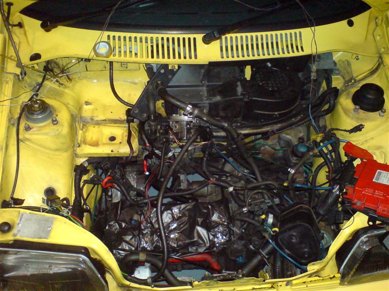

Hi all, sorry for bringing an old topic back to life.
But I am trying to get some wires through my bulkhead, I've had a couple of cinqs apart down looms and just can't seem to find that grommet, where about is it?
It's for a set of air-horns, got all my wires sorted, and my airline just needs abit of a neaten up, just need to get the wires through.
If only I could borrow some of the holes off my brothers land rover, plenty of rust holes in his bulkhead.
Thanks in advance,
Matt
Depending on the model follow the loom by the ecu and wiper motor or use the speedo hole, there is also another way to wire the airhorns, try using the horn line for a relay impulse and use the cig lighter as your 12v for the compressor
look up near where the battery should be.
and then closer..
Or extend the wire from the current horn that way if you tap the button you get the current horn hold to play dixe.
