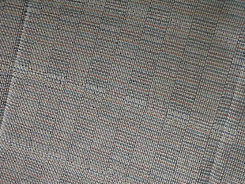

repairs beeing done on monday (hopefully!) found a drivers seat with a different pattern to rest of car (1000s stripes) at lock up 1,(y)
