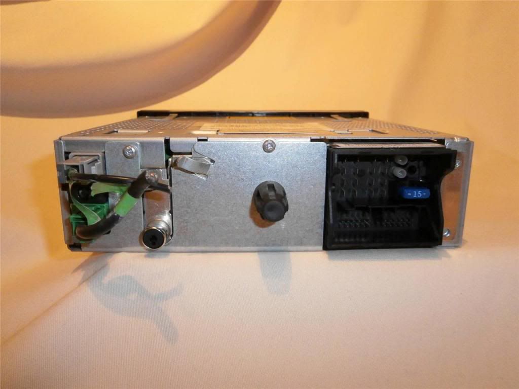

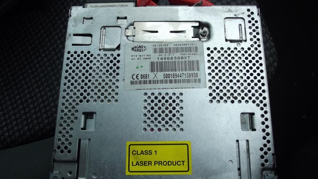

Check your RT3 Unit and ascertain if it's an N1 or N3 (the N1 doesn't have the fibre link connection for the screen!) you will need to partially remove the unit to see the identifier label (see pic)
The difference can be seen in the next 2 pics if you look in the top right hand corners of the connector Just above the fuse) you'll see the difference between them.
RT3 - N1
N3
