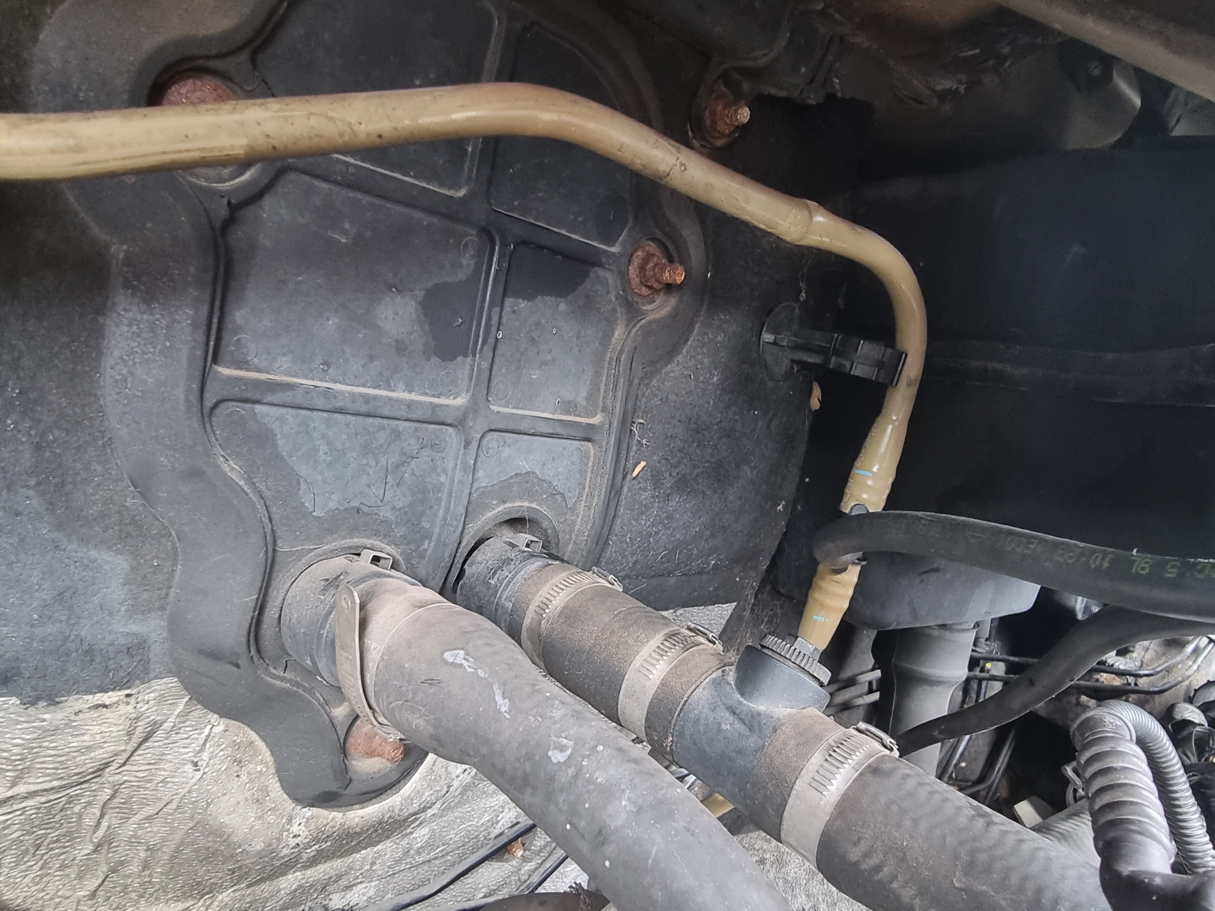

@Ducatomick1988 it is fixed! What a terrible fault that was. I replaced the vaccum pipe (ive qttached a picture of the pipe in question) and it has sorted it. @LandyAndy does make a very valid point co concerning the throttle body. I knew I had a vaccum issue as I had no vaccum to my egr control valve. If you do I would definitely be checking the throttle body, you can remove the air pipe and give it a good clean out (personally I would spray cleaner on a rag then clean it rather than spraying it directly into it), Also I would check the electrical connector make sure it hasn't got any green/dirty pins. Good luck!
Excellent! I had a look at mine today, I could only remove the thin black rubber tube that meats the T connector I couldn’t pry the cream ones off, did yours come off easily? I unplugged the electrical connector from the control valve and as soon as I did that it through up an engine light on the dash that now won’t go! I’ll have another go at taking the other cream vacuum pipe off tomorrow. Where did you purchase a new one from? Did you replace both or just the section that goes into the bulkhead
@Ducatomick1988 , It all comes as 1 pipe, from the brake servo (in the first picture) to a metal pipe (I'm guessing attaches to the vaccum pump) down the back of the engine. If you can get that small black pipe off the T piece, I would do take that off and start it, then put your finger on the T piece and see if you can feel a vaccum if you can then that is not your issue. I got my pipe directly from fiat commercial, was £41

A quick note to chaaarlieee. Looking at your photos, the brake servo vauccum reservoir looks pretty rusty. Mine was similar so I gave it a good coat of Waxoyl, as I didn't want it to get any worse and end up with a pinhole leak and having to fork out for a new one.
Items like this only seem to have thin passivation plus a quick misting of black paint, which is only OK for about 5 years. Ducato sumps seem to go the same way, you would never think a sump would rust through but they do !

Chaaarrlieee's photos are interesting: so on the basis of expanding my knowledge base/being nosey: (delete as appropriate); the vacuum pipes are connected to what appears to be similar to inlet & outlet pipes for the heater matrix. This obviously can't be so am wondering where these large vacuum pipes lead to?
Hi
The second photo isn't clear, but I can confirm (having looked at my van this morning) that the pale coloured plastic pipe rises vertically, presumably from the vacuum pump on the clutch end of the engine, then goes across the bulkhead to the brake servo. Just above the bit where the pale pipe goes past the heater hoses, there is a tee junction with the smaller black hose to supply the EGR solenoid. I would guess that this tee piece has a tiny hole for the EGR feed, so that if the black hose split/drops off you don't lose all the vacuum to the servo.
Thanks Anthony for that explanation, it all makes sense now, lol! I thought the beige plastic tube was connected to what I now realise is the bleed point for the heater matrix. Will look at my engine next time I'm in there.
