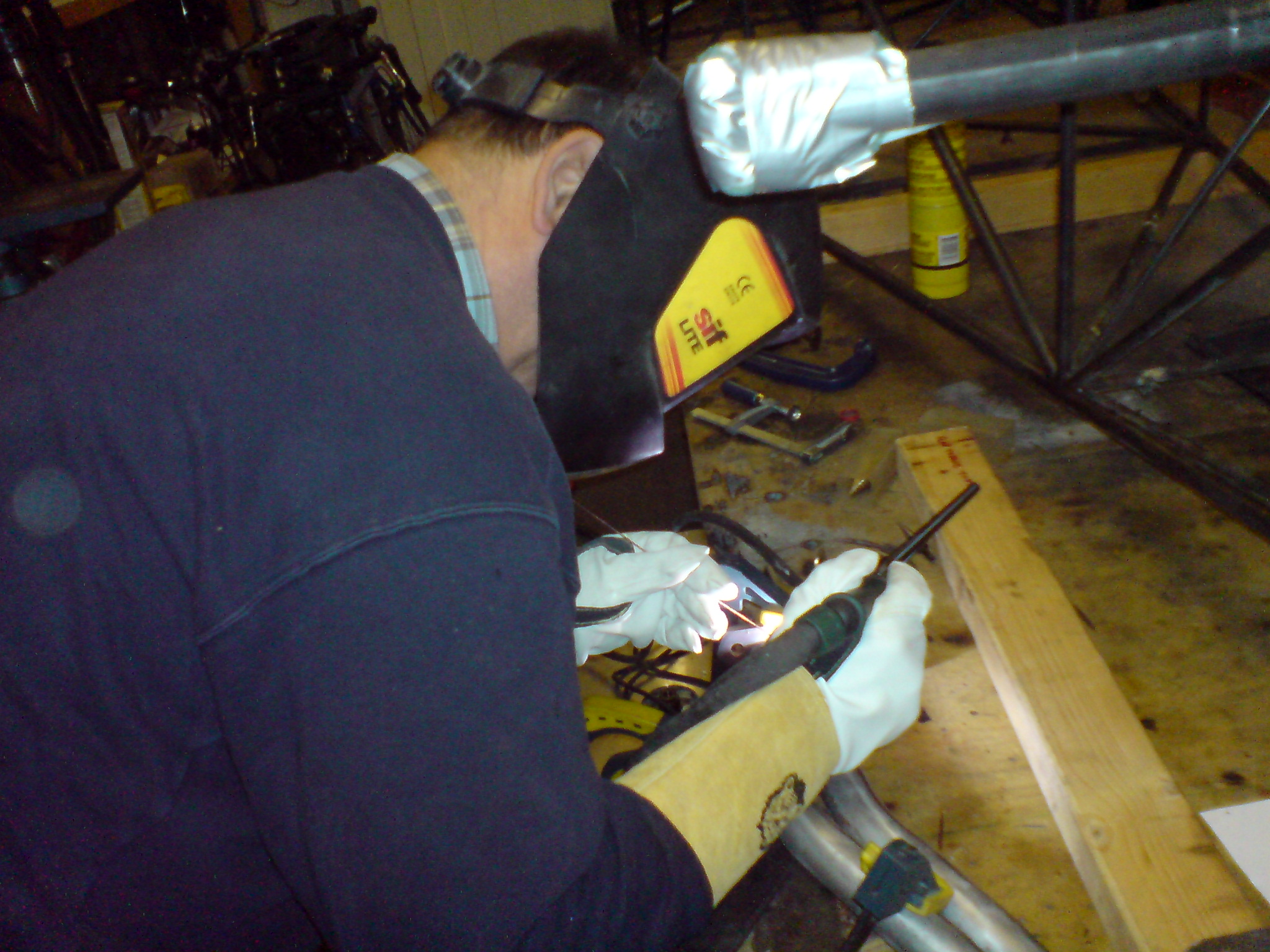

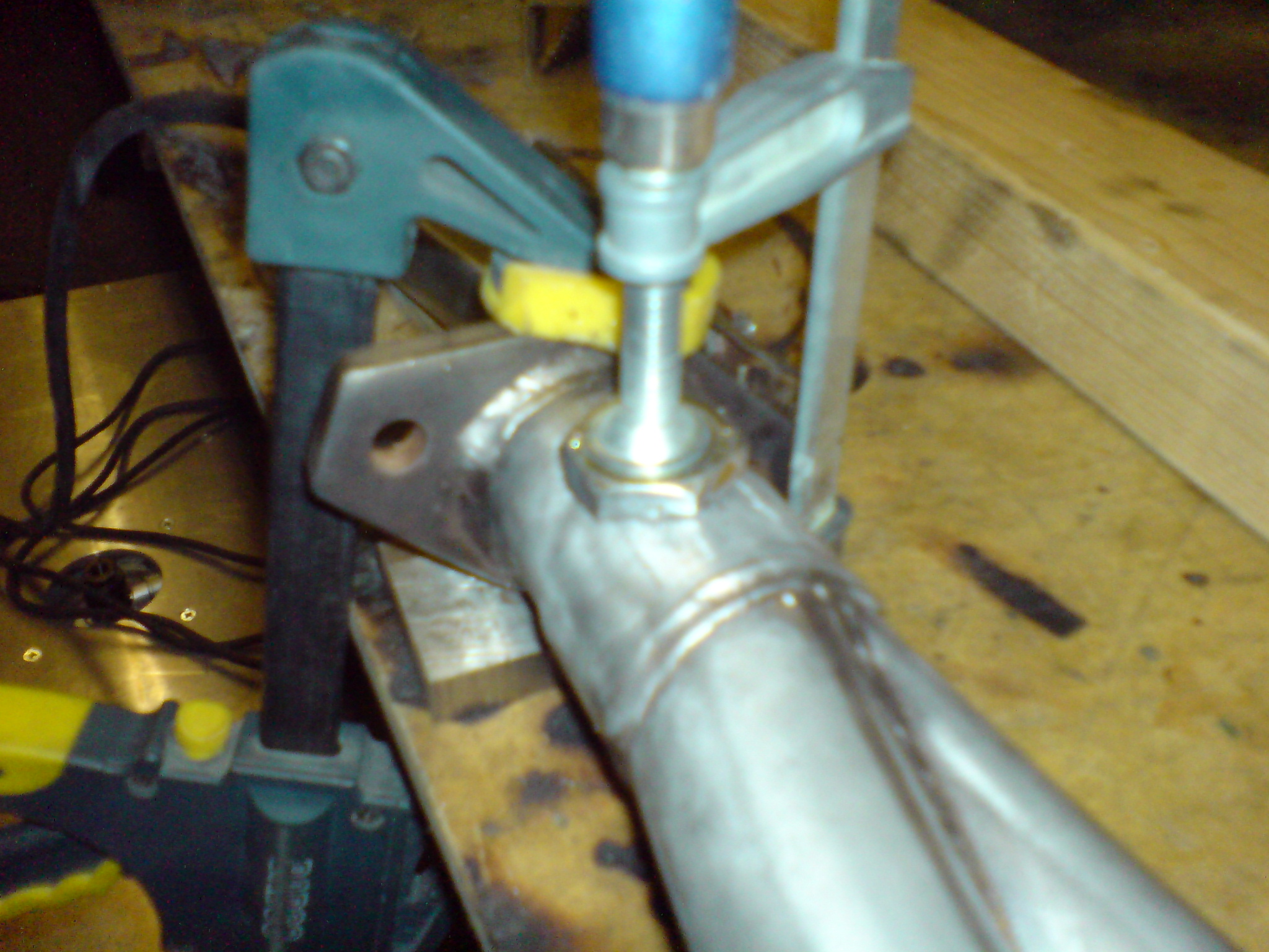

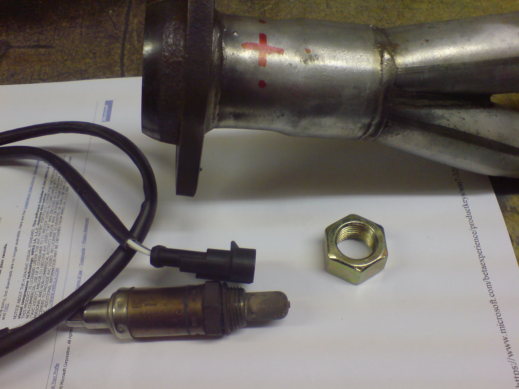

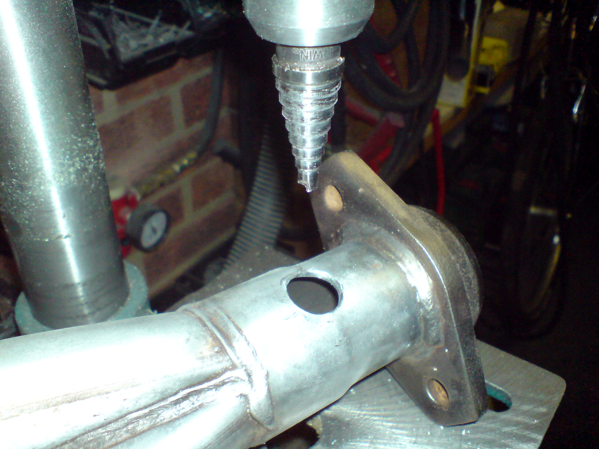

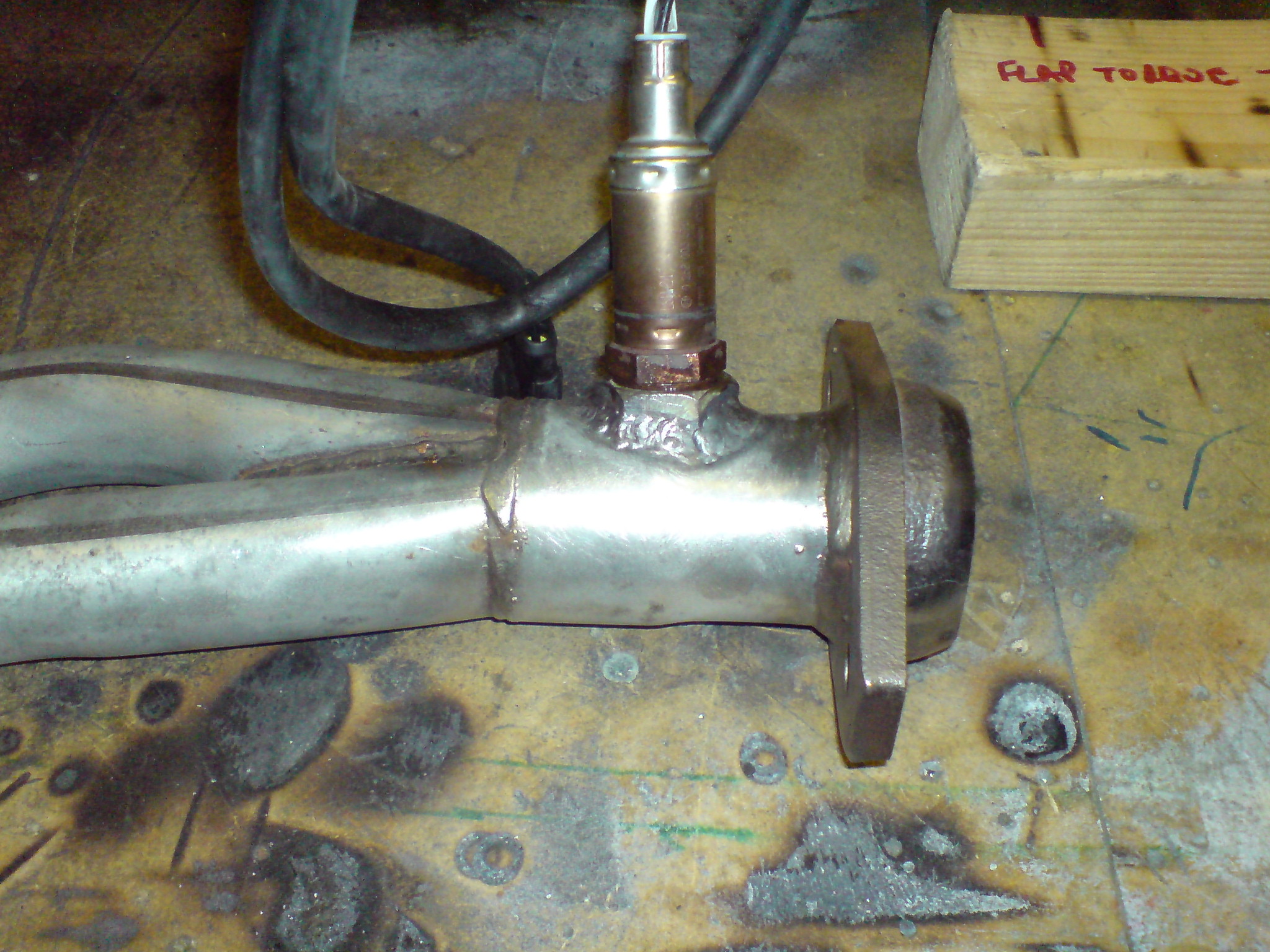

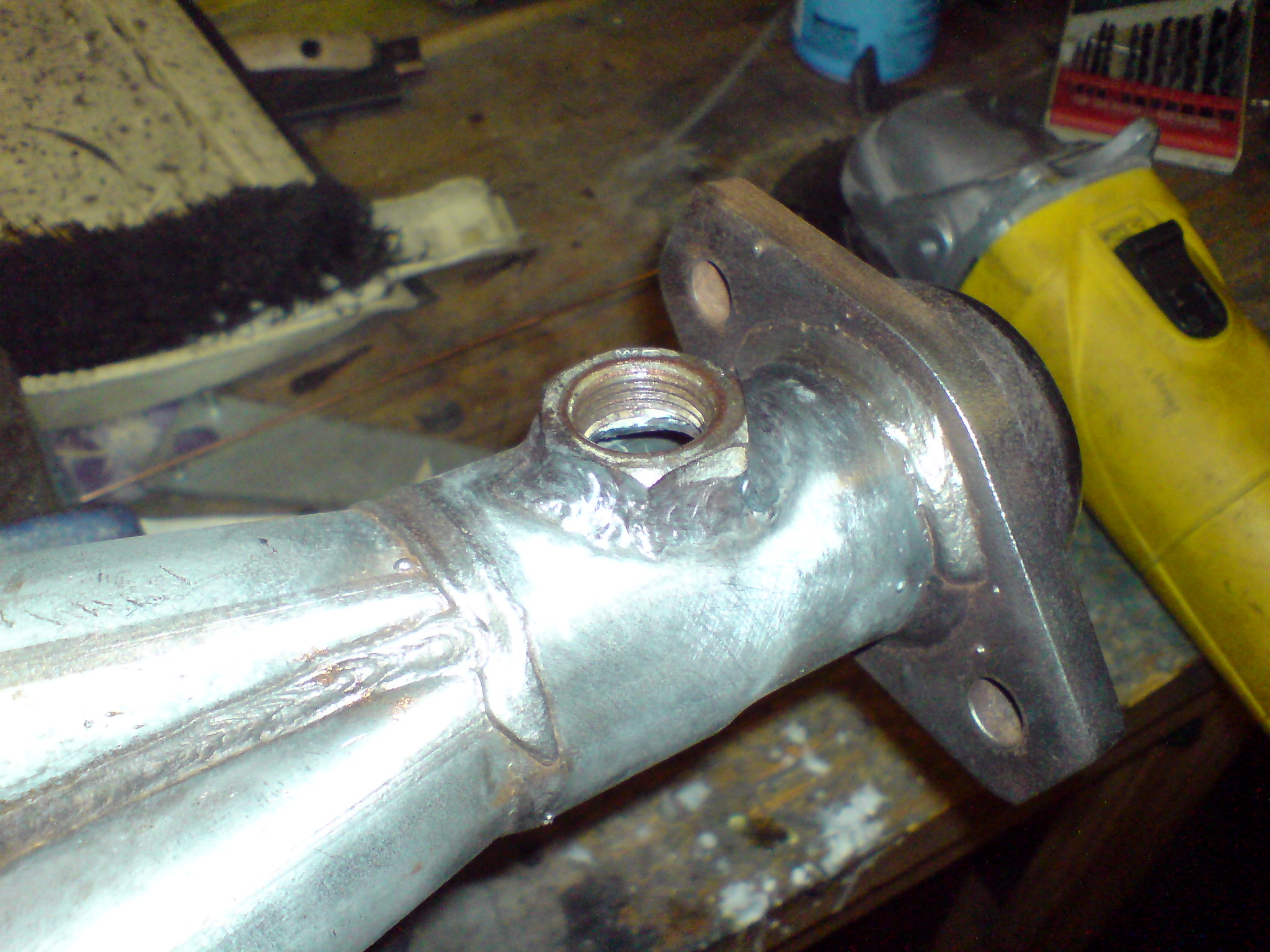

Here's some pics of my Lambda sensor installation in a Panda 4x4 exhaust.
Just bought an M18x1.5 steel nut. Positioned it according to Lambda spec. Welded the blighter on! Lovely :cool:
Neat eh? (Pops on the TIG)
