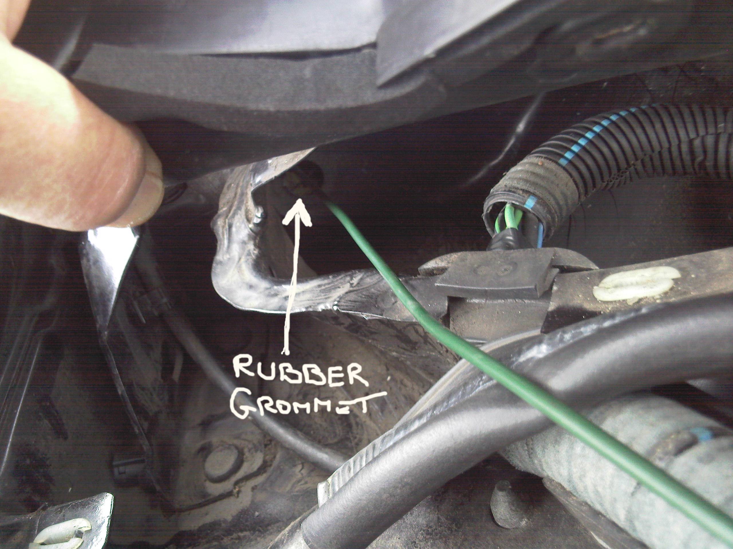

For anyone looking for a way through the bulkhead a couple of pics to show you the way it took me ages to find a decent hole.Youl need to lift the end of the plastic panel up and in the corner is a rubber grommet you might be lucky and get through straight away or you might have to wiggle your wire dont forget to put the grommet back. Dont know wether its a bit obvious but its the drivers side.

Also, if you look under the other side of the plastic panel there is a large rubber bung that enters the cabin above the glove box.
Its near the pollen filter, beside where the big wiring loom goes into the car.
Well, my ELX has this anyway!! I'm sure someone has already posted a thread about this access point.

i know about this one but didnt want to use it incase rain water got in and fried the ECU ;)
also, its on the wrong side of the car lol
Thanks for posting, I only ever looked at this when I had my horn clockspring problem and in the end fixed it without running a new wire, but there are not many holes in that firewall!
