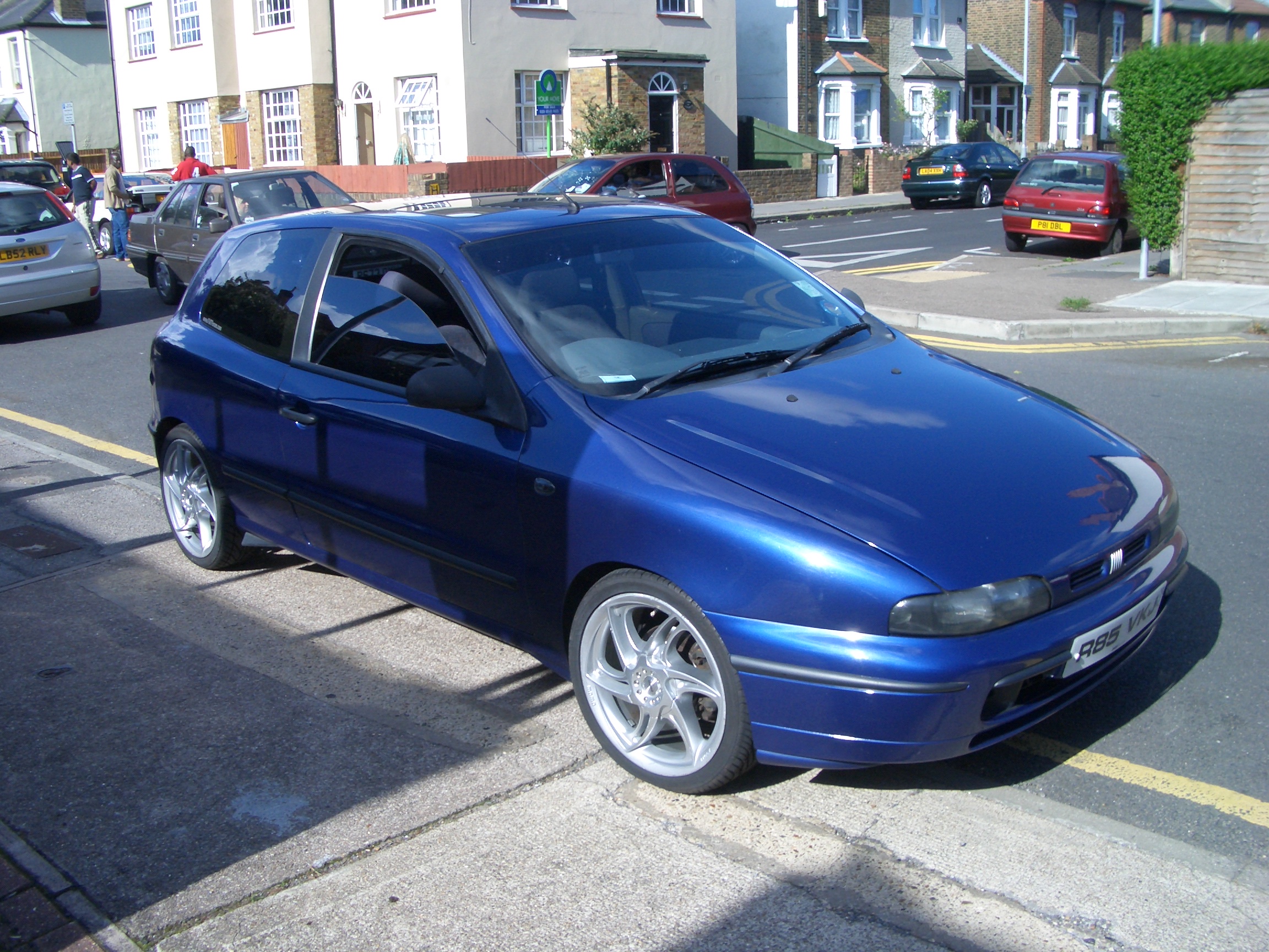

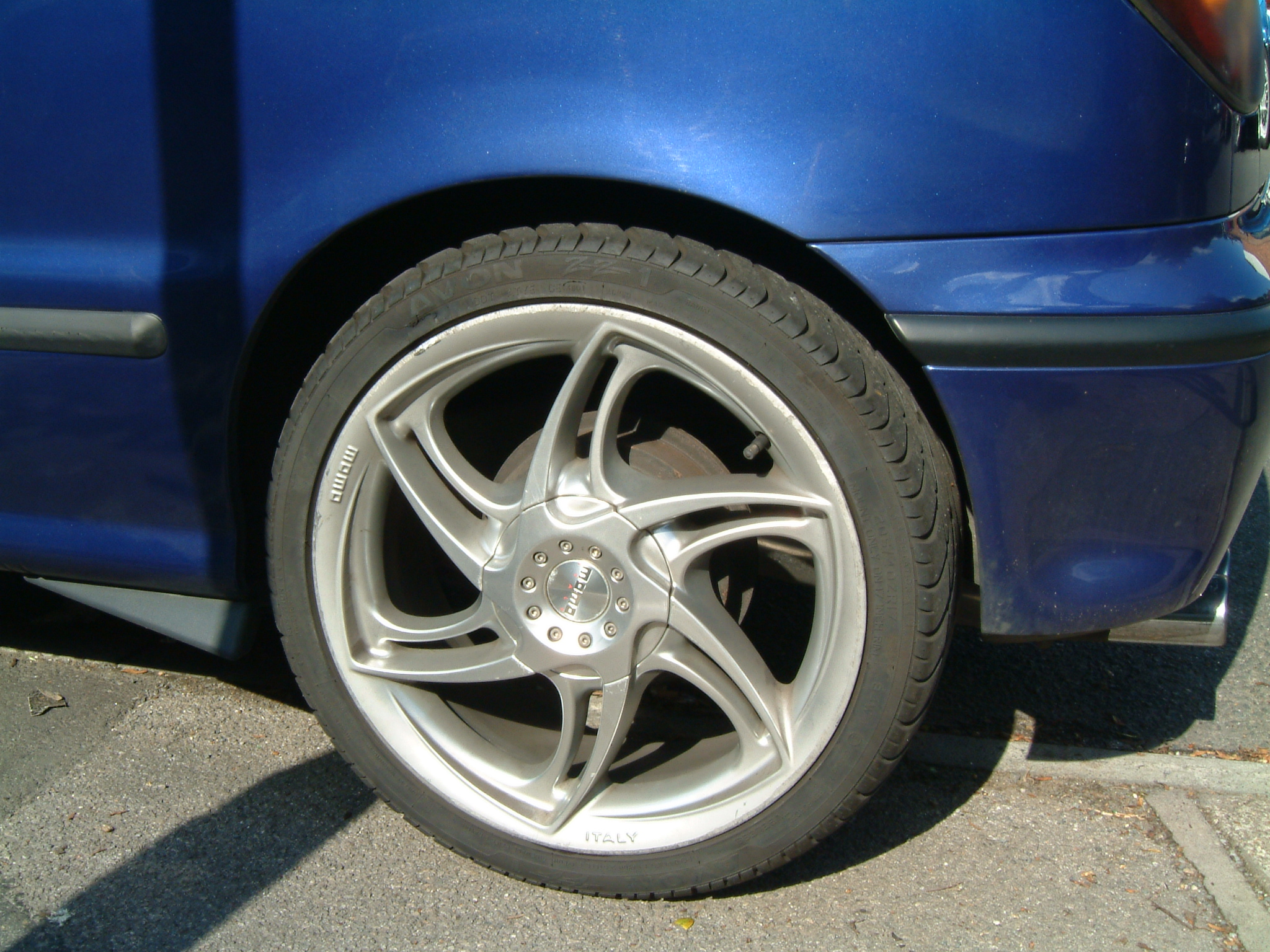

hi kokoloko sorry bout the delay as promised here is the pics!
fiat bravo sx 1.6 16v fox racing 205/45 R 17
hope this helps!
