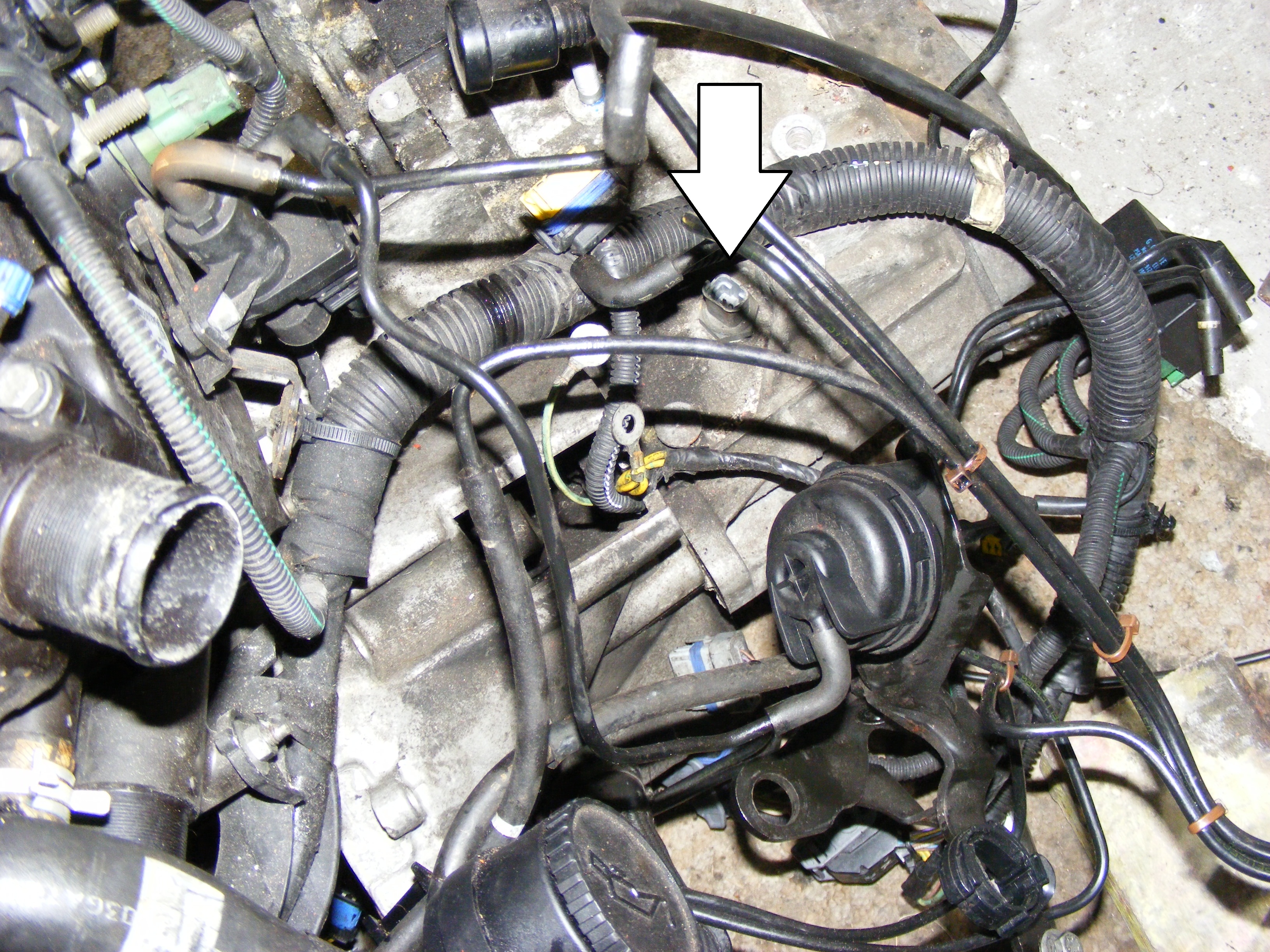

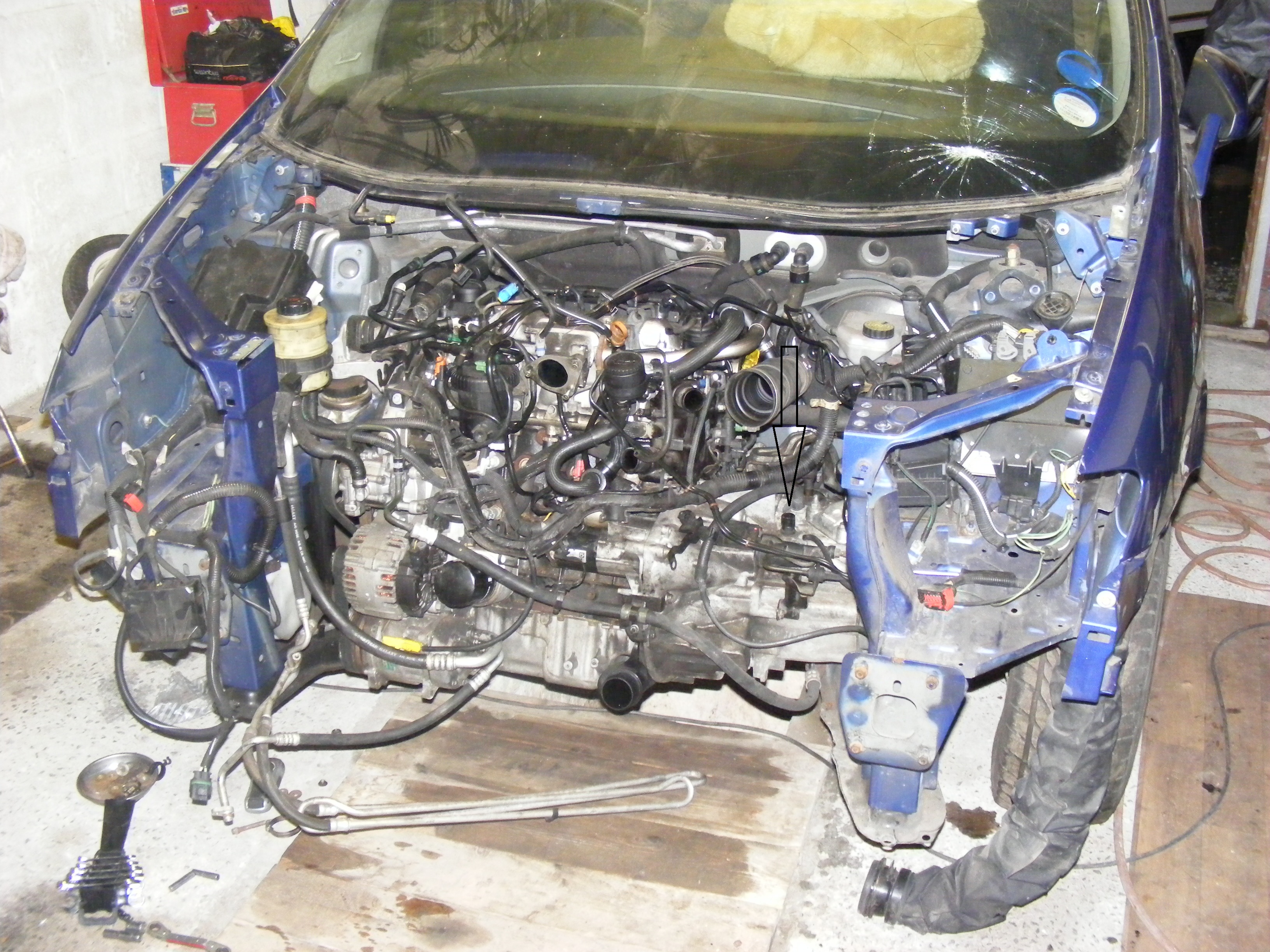

hi all, i have a 2004 1.9d ulysse and think that the reverse switch has gone as the reverse lights stay on while driving, as i am no mechanic i would like some help to find out where this switch is please
On cars fitted with the ML5 gearbox, the reverse switch is on the top of the gearbox, next to the gearbox breather.

Item 11 in the diagram below is the reverse switch on the ML5 gearbox.
Hi
Attached pics show Breather & Switch arrowed
Mav
