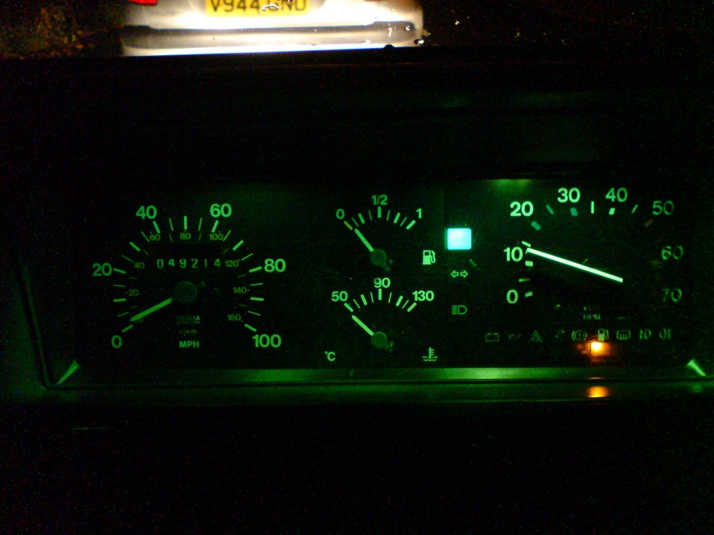

I tried and didn't work in my Panda :(
Had to find rev counter for 2 cylinders car and connect to one ignition coil
and that's my last project...
That's how I did it

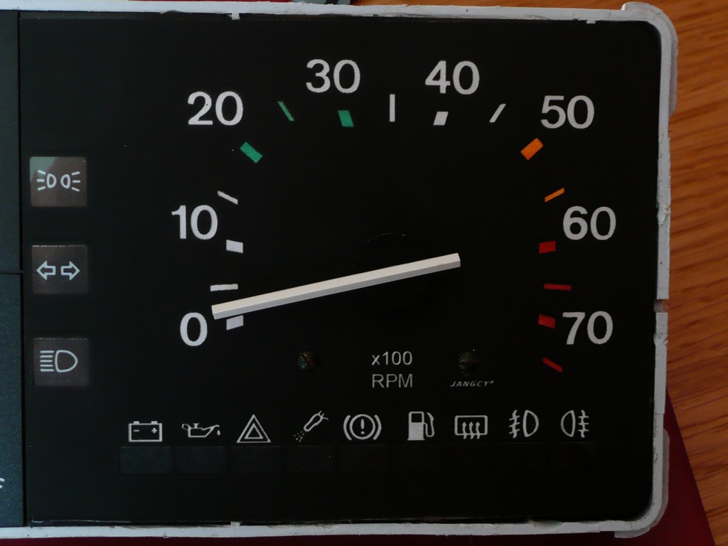

Jangcy, what car did you get that rev counter from? It looks really neat in the IP. (y)
It's long story...it's from polish FSO Polonez...because it's cheap...and easy to change from 4 cylinder to 2 cylinder. Then I prepare own backgroud print and screw it to oryginal panda plastic plate...
...I preapre some guide later....
