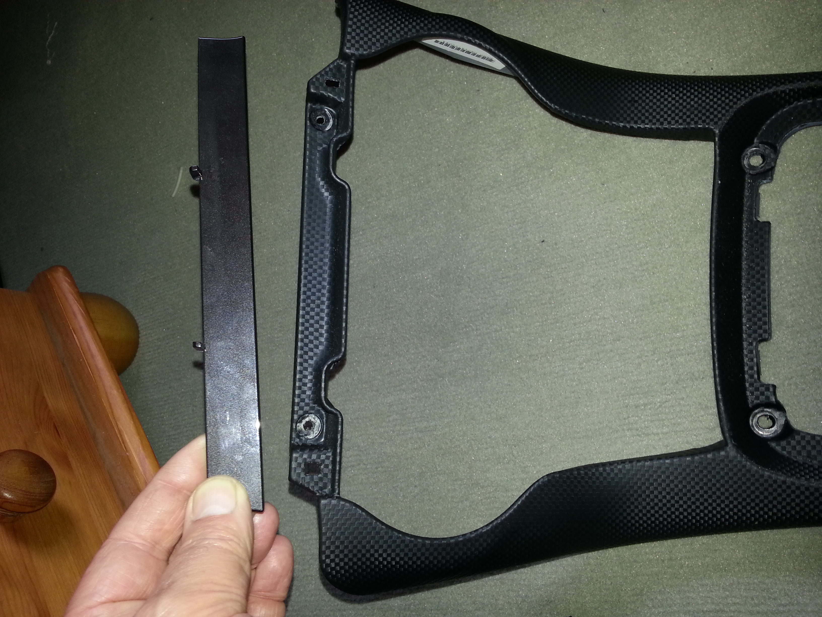

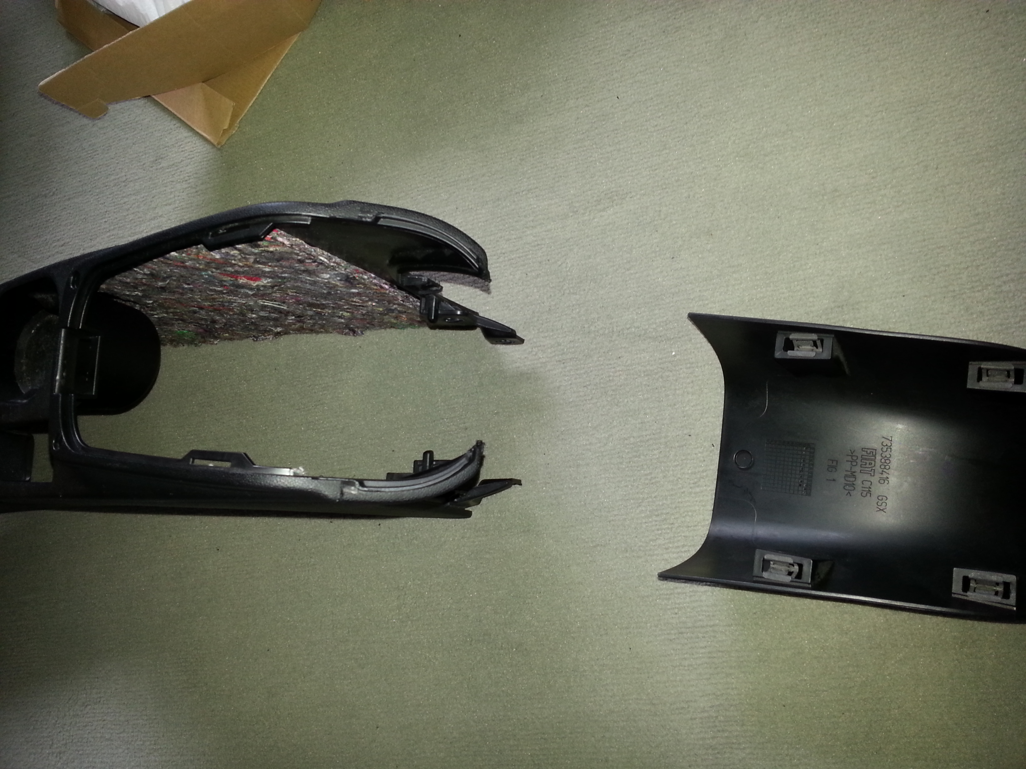

These are the pieces you need to remove and the part is less than £20 from a Fiat dealer. When you have the handbrake cowling off, turn it over and there are three spring clips to remove then the sliding cover comes off.
