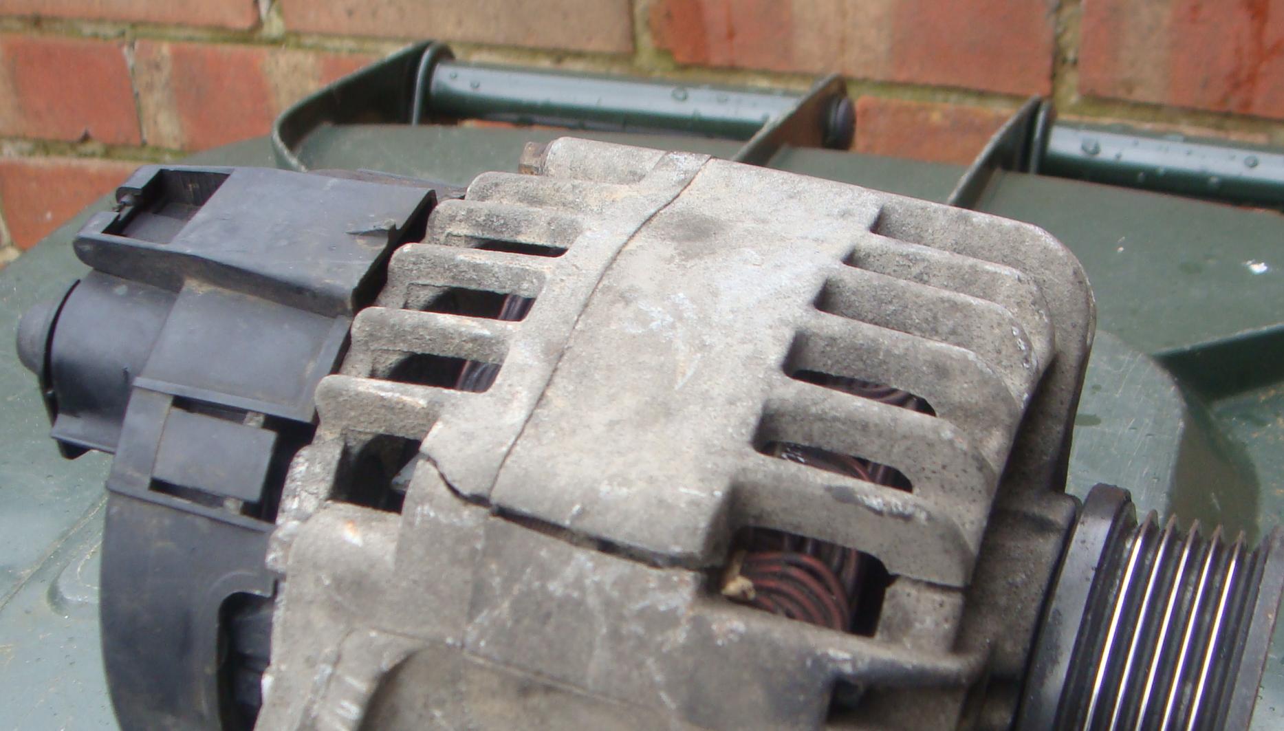

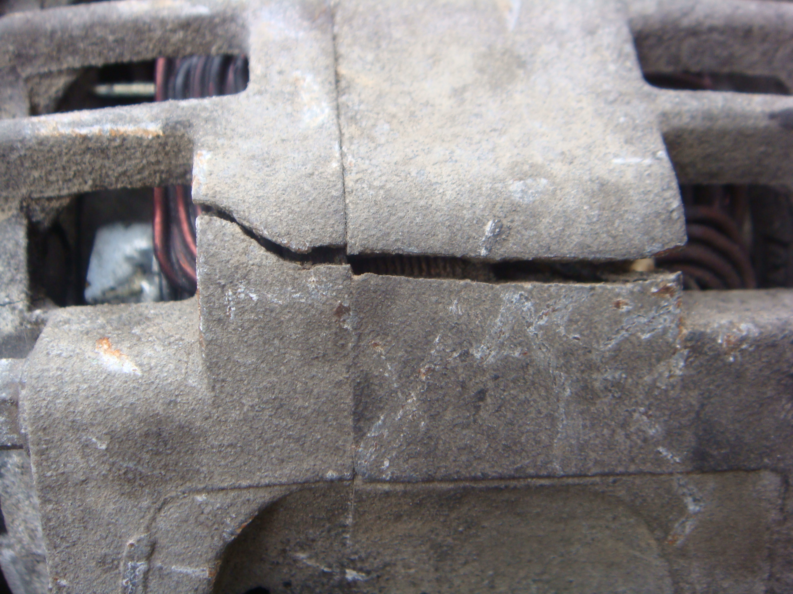

Alternator has usual cracks on it. Use jump lead from battery to engine block next.
Alternator was kciking out 14.0 V after it ran for a bit.
Cracked casing on it - as usual !
