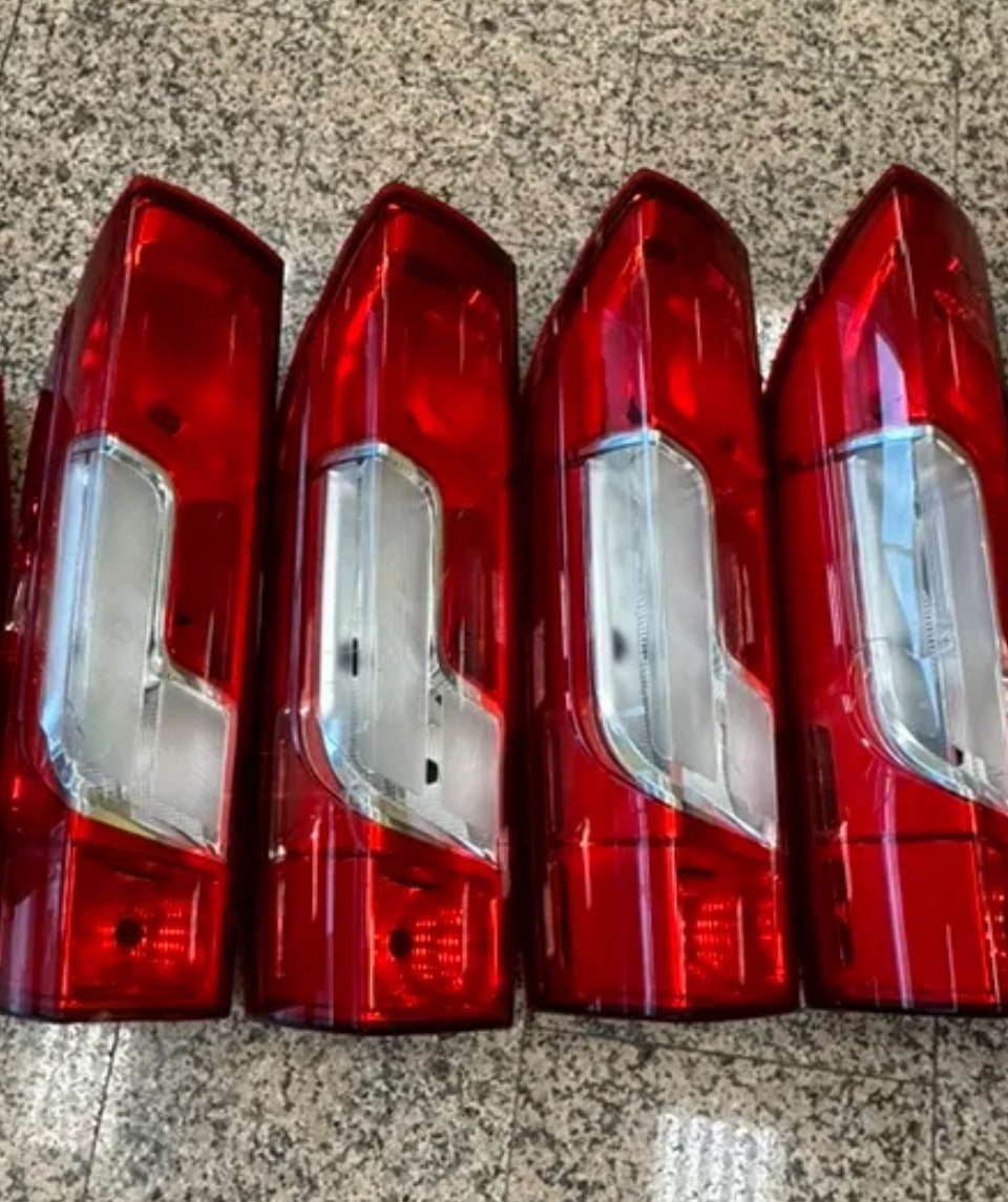

Hi!
Is it possible to replace rear light in my 2012 Ducato with the restyled version 2014+?

Hello,
As far as I remember, yes. I've saw it somewhere, but have no idea if it was this forum or another. Have you tried searching via keywords?

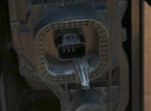

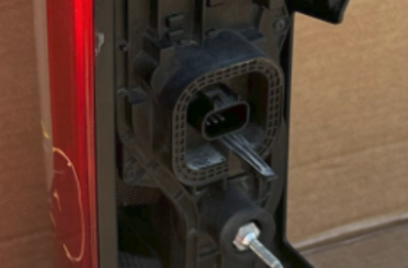

Physically it should be plug and play, the only thing to check should be the wiring. You'll also need to replace the part that holds the bulbs (new ones are often sold without this part). That's how the socket looks like:
I'm sure its possible but it won't be an easy straight swap - plugs are different for a start
