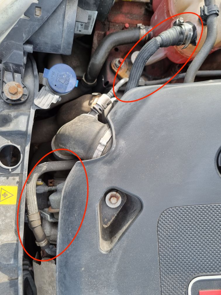

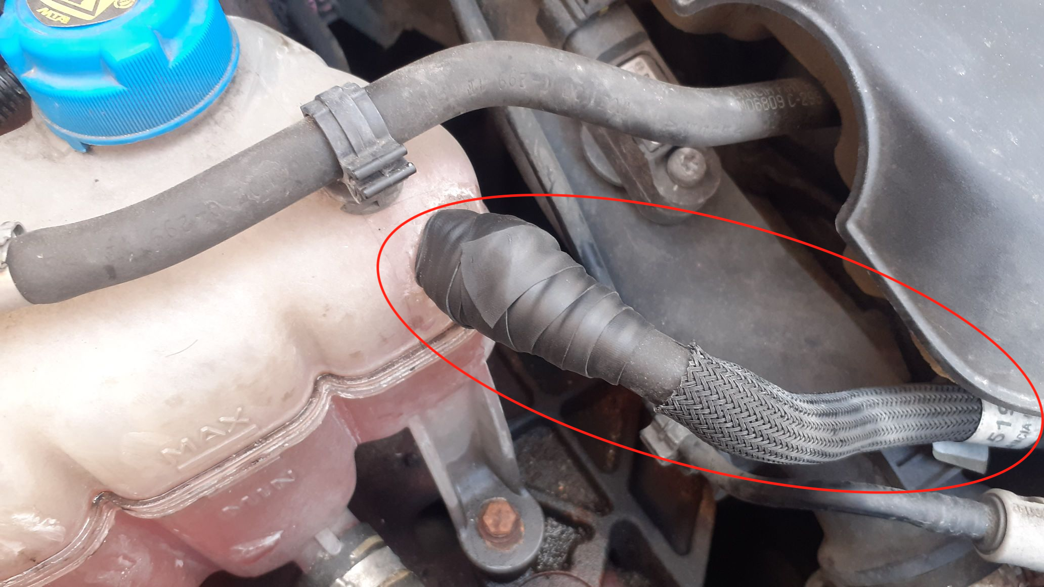

Hi all, a rubber tube going from the coolant reservoir began leaking some time ago. I made a temporary fix with some self-amalgamating tape, but I'd like to replace it now. I'm having trouble finding a replacement part - maybe someone could help me with that?
On the tube, there is a number: 51910227. I found it in the ePER (https://eper.fiatforum.com/Part/SearchPartByPartNumber?language=en&PartNumber=51910227) which told me that the previous number for it was 51943088 and that it is nb. 3 on this drawing https://eper.fiatforum.com/en/Drawings/Detail/F/F/GIN/33/104/1/30/1/0/SubSubGroup/51943088.. which could match the photos, even though it's not shown going out of the coolant reservoir like nb. 15 is?
Q1: Is the product code the same as the OEM number?
Q2: In the last link; should I understand it as that all product codes listed under nb. 3 are interchangeable? So can if I find a part that lists one of the other product codes, can I be sure that it will fit?
Q3: I'm having trouble finding any parts just by searching for the number. Online car parts stores like autodoc, don't seem to mention any of them. I don't need the part to be original, just to fit. Is there a trick to finding the parts? If anybody knows what part this is and has a tip for what to search for or a link to it, it would be greatly appreciated!
Sorry for the newbie questions, I'm new to this :)
