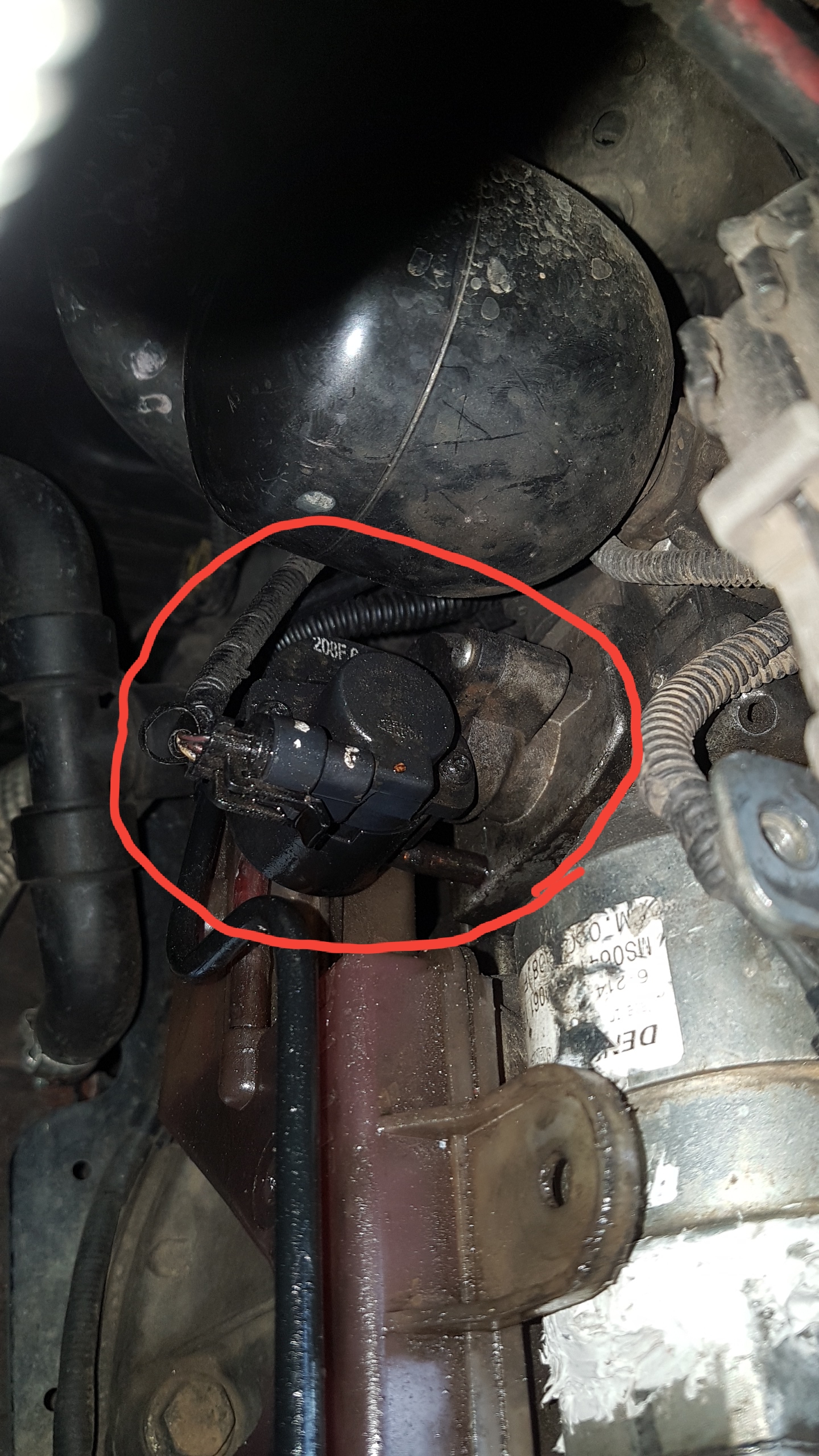

Thanks for responding to all these questions. Had the car up on a ramp today to replace the steering rack ends. Removed the pump cover and there was an oil leak coming from top front solenoid. I'll post a picture in a few minutes.
Regards
Hi Bernie,
This is the one I found leaking.
Also to answer your question, yes as soon I turn off the engine the pressure drop rate reduces significantly.
Regards

As Bernie said ... the accumulator has the membrane torn/broken..or just microleaks... pressure will drop very fast after leaking very little oil....it's just how hydraulics work. You need the air/gas in the accumulator in order to keep higher/constant(ish) pressure for a longer time.
I's probably not the only issue, there might be some minor leaks in the system (internal -checkvalves not sealing- or external the small leak we are seing the that picture).
A leak, one drop every second in a system that contains only uncompressible liquid will cause a massive drop in pressure in a very short time... whereas the same leak in a combined system will take minutes to loose all pressure.

The oil leak seems to be coming off a hose instead of the solenoid itself. Can only confirm after fitting a new hydrolic hose. This is the oil return line which was in bad shape and broke when doing the repairs last time.
