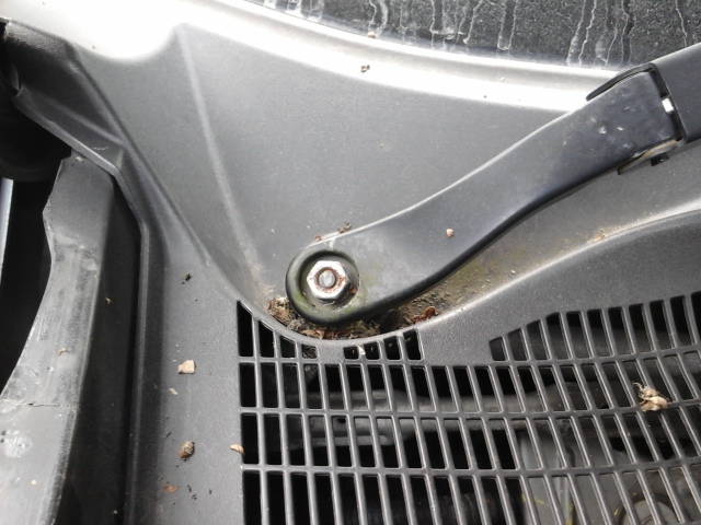

Under the bonnet, remove the heater plenum cover. Mine had been off before and had been replaced with self tappers - I think they are normally plastic pegs.
Lever off the plastic caps on the wiper spindles and undo the nut. Remove the wiper blades.
No need to completely remove the cover - you can work under it.

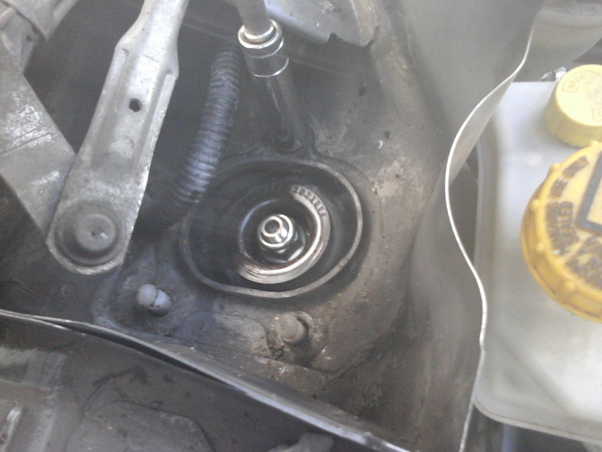

Loosen the 3 nuts on the top mount and the strut shaft nut - don't remove it yet!

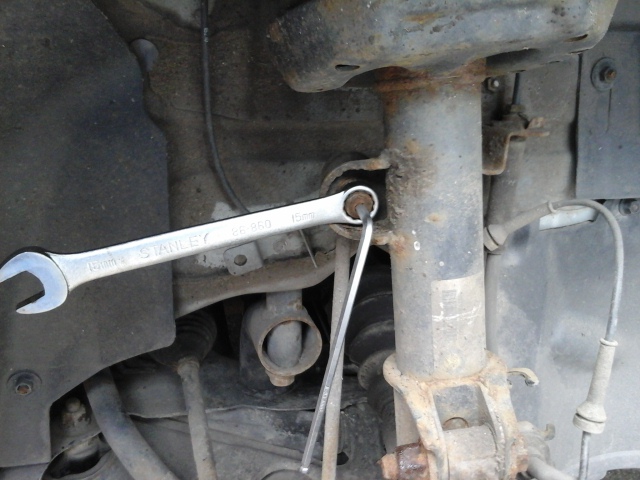

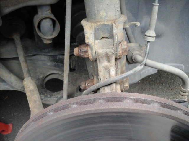

Loosen the 2 large bolts that secure the hub to the strut.

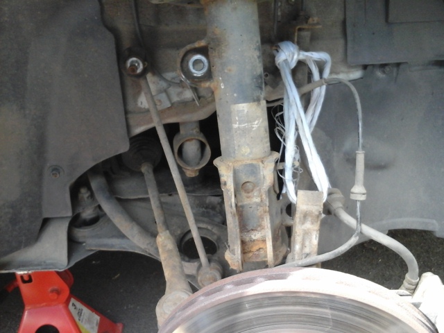

Undo the drop link - or remove if replacing.
Un clip the brake hose and wire.
Remove 2 large securing bolts and retain the hub with a bit of baler twine!
Remove the 3 strut top mount bolts under the bonnet.

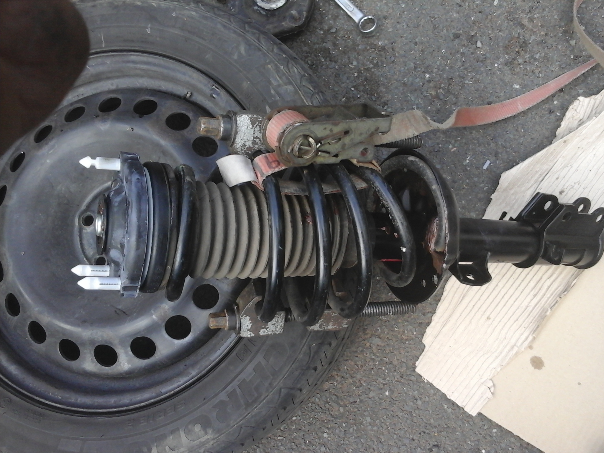

Now the dangerous bit. Using the proper tools, compress the spring enough to relieve pressure on the top mount. Note my use of ratchet straps - this is an extra safety measure as the spring compressors are known to slip.
New strut with fitted spring and top mount.
