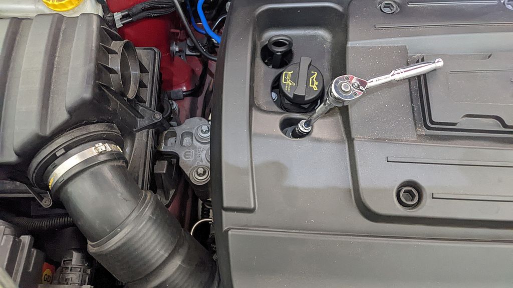

1. remove engine cover: 10mm socket
2. pull off clip for air hose
3. remove air box lid by undoing 3 phillips head screws
4. pull out base of air box: 1 connector to engine mount (shown below); 2 connectors to side of car; 1 air pipe
5. remove engine splash shield (10mm bolts: 2 at front and 2 at back and several phillips head screws) and support engine with trolley jack and timber
6. undo bolts and replace mount (torquer specs at the end)
7. replace all bits and do other side!
