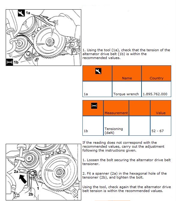

Instructions from the Stilo workshop manual are below.
Nobody uses the torque wrench tool to measure the tension.
The tool 2a is a hexagon Allen key as shown in the diagram, not a spanner as stated in the description.
