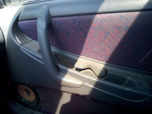

Cry for help here. My car is a Series 1 Lancia Y, but they are mechanically identical to the S1 Punto. The passenger window has failed, and I want to get the door card off to fix it. However, for the first time in my life, I simply can't work out what to do, and it's not in the manual. The problem is that I can't work out how to dismantle the armrest and door handle mechanism. There is a big bolt at the top with a cap over it - I have had that off before, but I can't find out what holds the armrest on at the bottom!
Can anyone help? Although it looks different from a Punto one, it will have the same fixing mechanisms and 'hard points', because the basic structure is the same.

Hi :)
As nobody else has offered..
Often the card is 'hanging' from the window aperture
With just the plastic poppers going around the perimiter
So start at bottom rear of card..
(After checking for screws in the oddments tray )
And with a flat implement..
Start popping the plastic clips out
Your door handle tooks like it is moulded into the oddments tray..
I seem to recall later trays were a fixed part of the card.. wheras early ones has 6/8 screws tieing them to the door
BUT there will probably be a BIG screw holding the top of thd handle to the doors inner structure
Have fun..!!

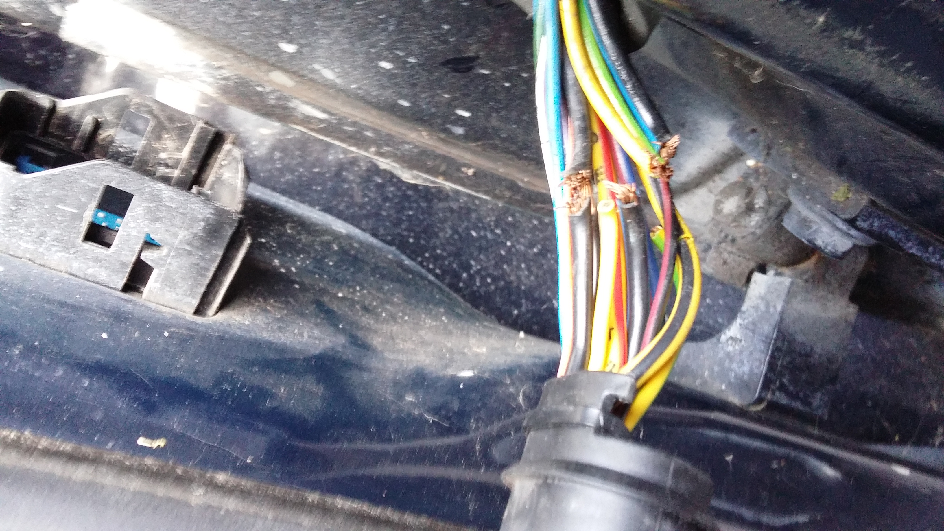

Check the wiring at both door joins..
It doesnt take much to stop them :eek:

Thanks - I appreciate that you pretty much always reply to my questions, of which there are many! I should have posted a zoomed-out picture - I have got the oddments tray off (around 6 years ago!!) and I have been as far as popping most of the clips and undoing the big bolt at the top of the door pull (the one that is covered by a pop-out cap), and when I had done that I confidently expected to be able to give a big yank and it would all come off.
But zilch! Nada! Niente! So I gave up for 6 years and just drove around with the window shut. But it gets very hot here in summer, especially as the sunroof has also packed up (that's not just the motor - I think the rack has stripped one side, because it has gone crooked and jammed in its runners - maybe I will post a thread on that soon, because I bet Puntos had the same sunroof...).
Anyway, even after I had got all that lot off 6 years ago there was still something very tenacious holding it all in place, and I think it has got to be that other big screw, which from the eper diagrams looks as if it is behind the well that surrounds the actual door handle (the 'ornament' - I am a translator, and if they had got me to translate the eper I could have told them the correct word was trim!). I have tried a few times to get the 'ornament' off and failed, but I think looking at the diagram that it must be held on by the big screw as well, so there must be another pop-off cover somewhere! Off out to look!

Is the door wiring perfect ?
My punto had intermittent.. then ZERO function to the passenger window with that damage I showed
