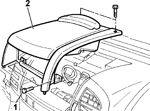

Hi every one, could some one give me advise on how to remove the console section above the radio which has the clip attachment, need to rewire a reverse camera monitor , the previous one was ripped out and stolen leaving just the bare wires.
HI
Remove the radio and there is 2 screws behind, also 2 more in clip itself. Hope this helps.:D
You will need to remove the radio by the retainng clips through the 2 holes on each side of the radio ( there is a special tool for this but you should be able to improvise ) attached pic of clip board screw locations.
