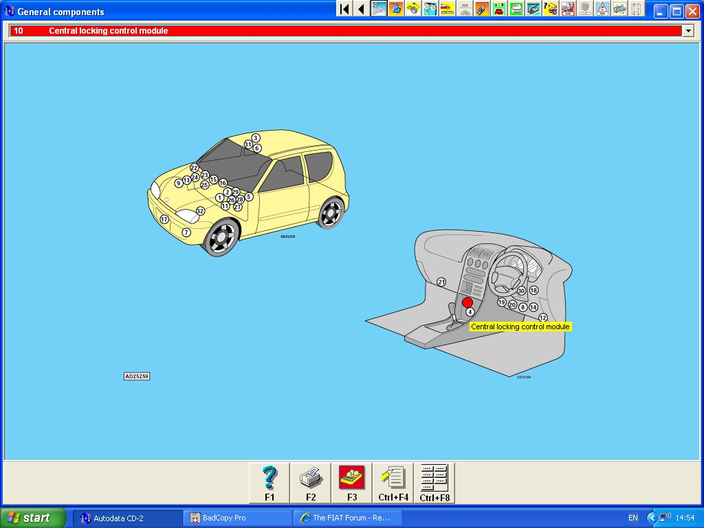

while trying to fit my all singing, all dancing alarm system I've killed my standard central locking, when it first went, it locked the car but wouldn't unlock it. Neo it does nither so its about time i replaced/repaired it. but i need to fid it first
well I'm still on the hunt, the bit I'm looking for is the relay that does the locking/unlocking on my autodata didk it shows it in the middle of the car, this is also where I've mounted the alarm box and where I saw the dreaded blue smoke of death. I'm not sure if it was the alarm or the standard central locking that got fried. but seen as now it doesnt work, I'm hoping it was just the standard one.
does anybody know where this is? BTW its a sporting MPI if they've changed anything
thanks

Behind the passenger side door pillar trim (lower section) are the cables.
The alarm should have two volt free relays. connect the commons to earth and then the relay outs go to the White/Yellow, Light blue/Red wires.
If the cenral locking opens the door when alarm is armed then reverse the connections to the W/Y, Lb/R wires.
I'm going to have one last go at the dam thing tomorrow, if your kicking around Barnsley anytime feel free to pop over, I've got beer and a good choice of takeaways. I do remember the second time I tried fitting it, when the alarm lock/unlock was pressed the wires to the lock contracted. you could see them move quite a bit. I ended up going through a lot of fuses too.
The central locking control module contains relays that change states from +12v out to 0v in, to reverse the motor.
If you connected to these to supply +12v to the motor from the alarm relays then chances are that one of the relays inside the C/L module took your supply to 0v creating a short. This can burn out or weld the relay contacts.
You probably need a new control module.
Also check the alarm relay contacts by powering up the alarm and checking continuity of the contacts on arm/dissarm. They should close for about 2 seconds.
Ive got autodata cd2 on disc.
great I've found it:woot:and one of the relays is melted. so, the plan now is to nip to the scrappys and get another one, I'll take the remote control part off mine so i wont need the key fobs. hope this works.(y)
