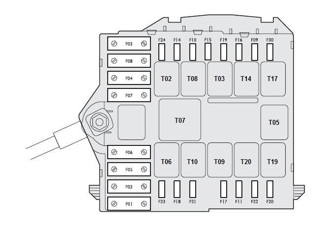

which is the starter relay on a 2003 stilo
Hi, Welcome to the FF.
For all engines except the 2.4 with Selespeed gearbox, there is no separate relay for the starter motor, just the combined relay/engagement solenoid on the motor.
If you have the 2.4 with Selespeed gearbox, then there is also relay T20 in the engine compartment fuse box.
