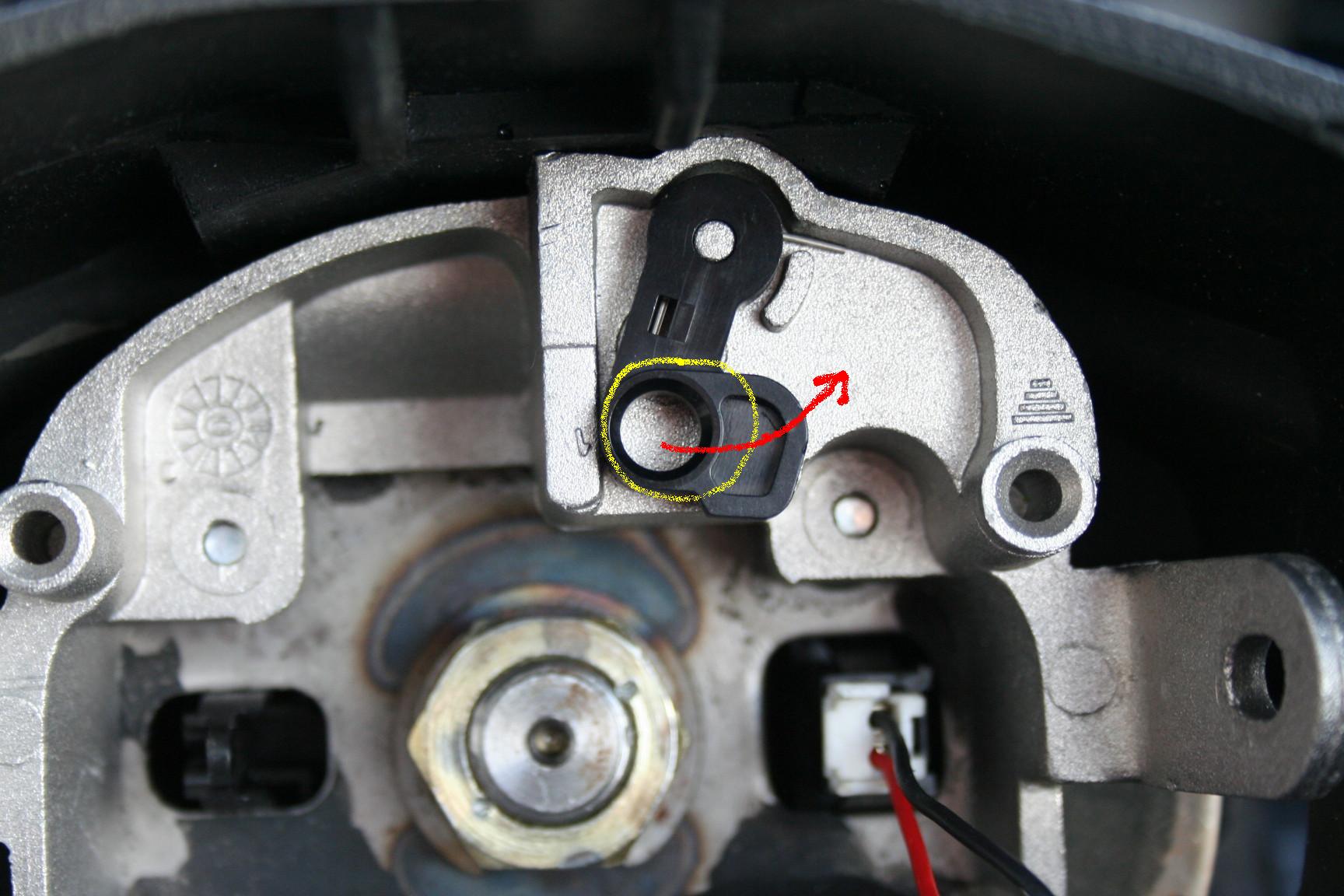

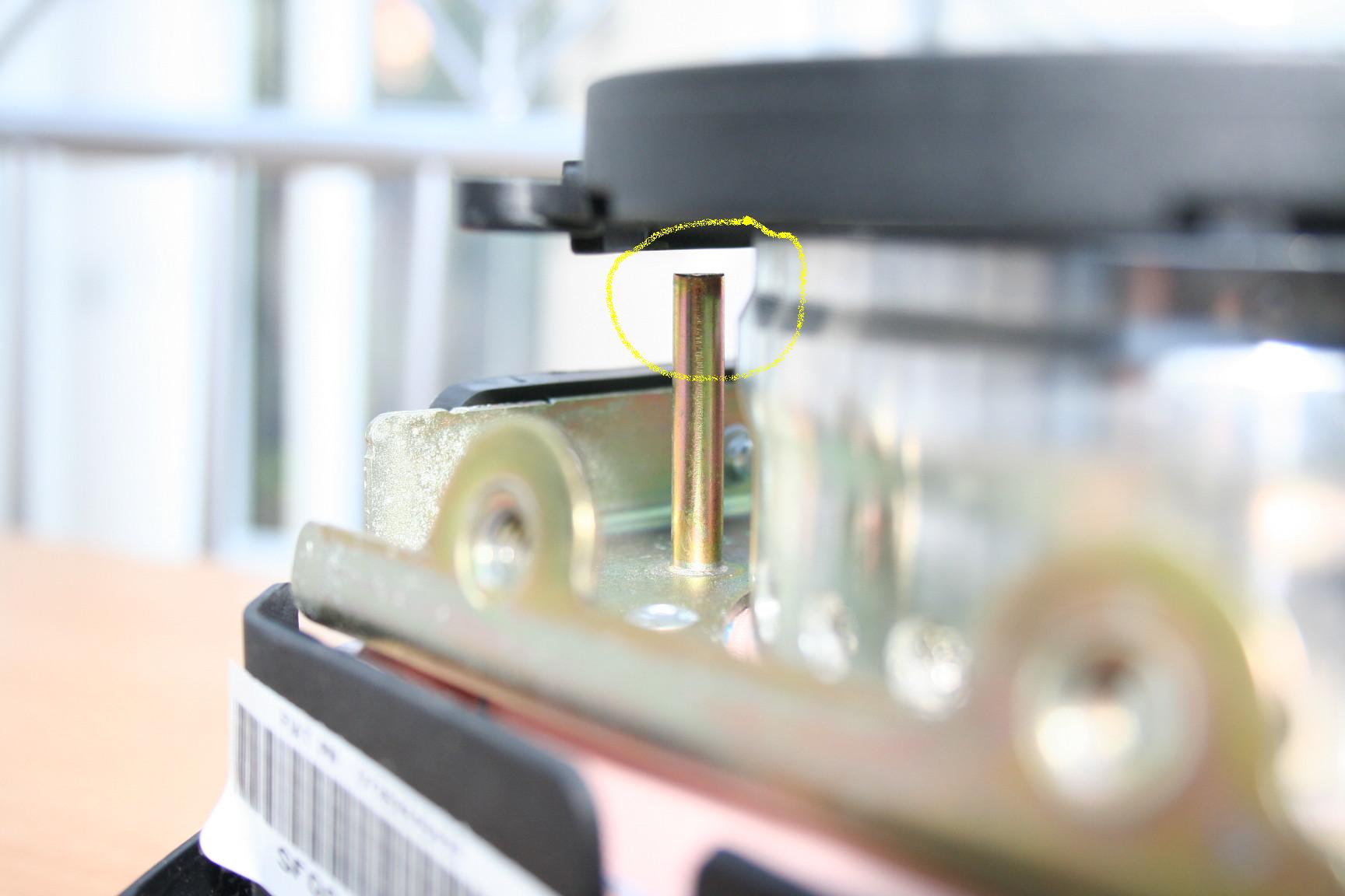

Ok, i took some snaps of the airbag and inflator assembly.
Fig 1 shows where i think the pin from fig 5 should go (highlighted in yellow)
Fig 2 shows the plastic arm i was speakin about with the spring. This seems to want to go to the right (in direction of red arrow) and being finally held by the pin from fig 5

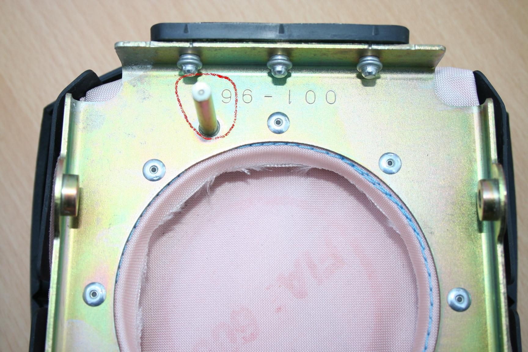

Figs 3 and 4 shows the pin on back of airbag (highlighted in red & yellow respectively) - does this go through the black plastic arm into the hole (from fig 2)?
Finally, how do you insert the inflator (fig 6) into the airbag. It seems to want to simply push inside it. Is this ok to push inside ? It means the pin will locate properly into the inflator assembly and thereafter into the hole from fig 1

DONE IT ! (finally)
The small black "L-shaped" plastic springy thing sits in its place (you'll note that it can only go one way) inside the steering wheel column against the metal. Next line-up and screw in the round plastic inflator holder (held in by 3 screws) and then when you slot in and rotate the gas inflator device clockwise against this, (it will then click into place) and BINGO! the holes line up at the top - allowing the airbag and the metal pin to slot into it.
Remember to disconnect the battery before you do it or you'll get the light coming on and need a dealer reset.
