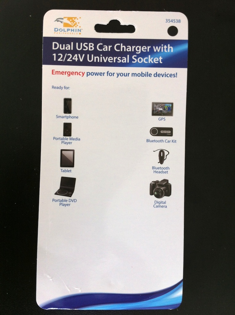

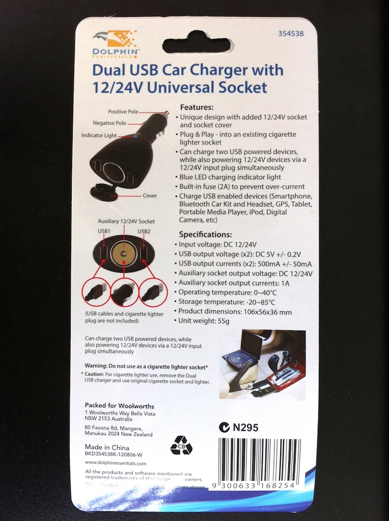

This is a very common problem unfortunately. Curse the 500's shallow cigarette socket! :(
Here in Australia, I've found that all the Super Cheap Auto (SCA) ones don't fit -- they're too "long", as you've found, so the metal side pins are too high up and don't make contact in the shallow socket. I then happened to see a Dolphin Essentials dual-USB + 12V adapter on sale at my local Woolies supermarket for $5 and that fit perfectly. It's now powering my TomTom Go 500 plus my front and rear dash cams.
So it seems to be the luck of the draw -- if in doubt, ask if you can borrow one to test.
