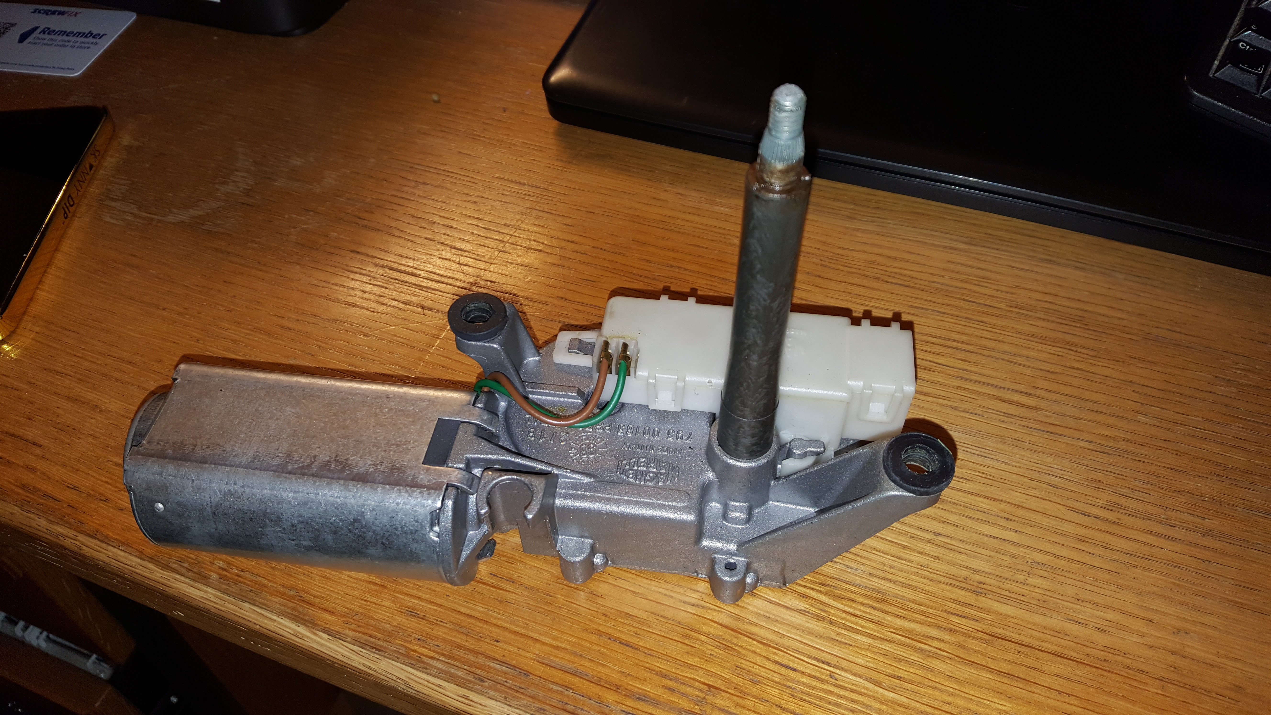

Hi,
I've followed the Guide on the rear wiper motor shaft unseizing which is great.
I'm at the point where I've removed the plastic cover (the one with the 4 little bolts and I can see the insides of the mechanism.). I have the motor assembly on my bench with the shaft in its plastic sleeve pointing upwards.
Does the metal shaft come out via the inside of the assembly or via the outside part?
IE: which side of the shaft do I hit? The threaded part where the wiper bolt screws into or the part inside the assembly?
Thanks
Pete
Hi, Please see pictures of what I mean (attached.)
Thanks
Peter

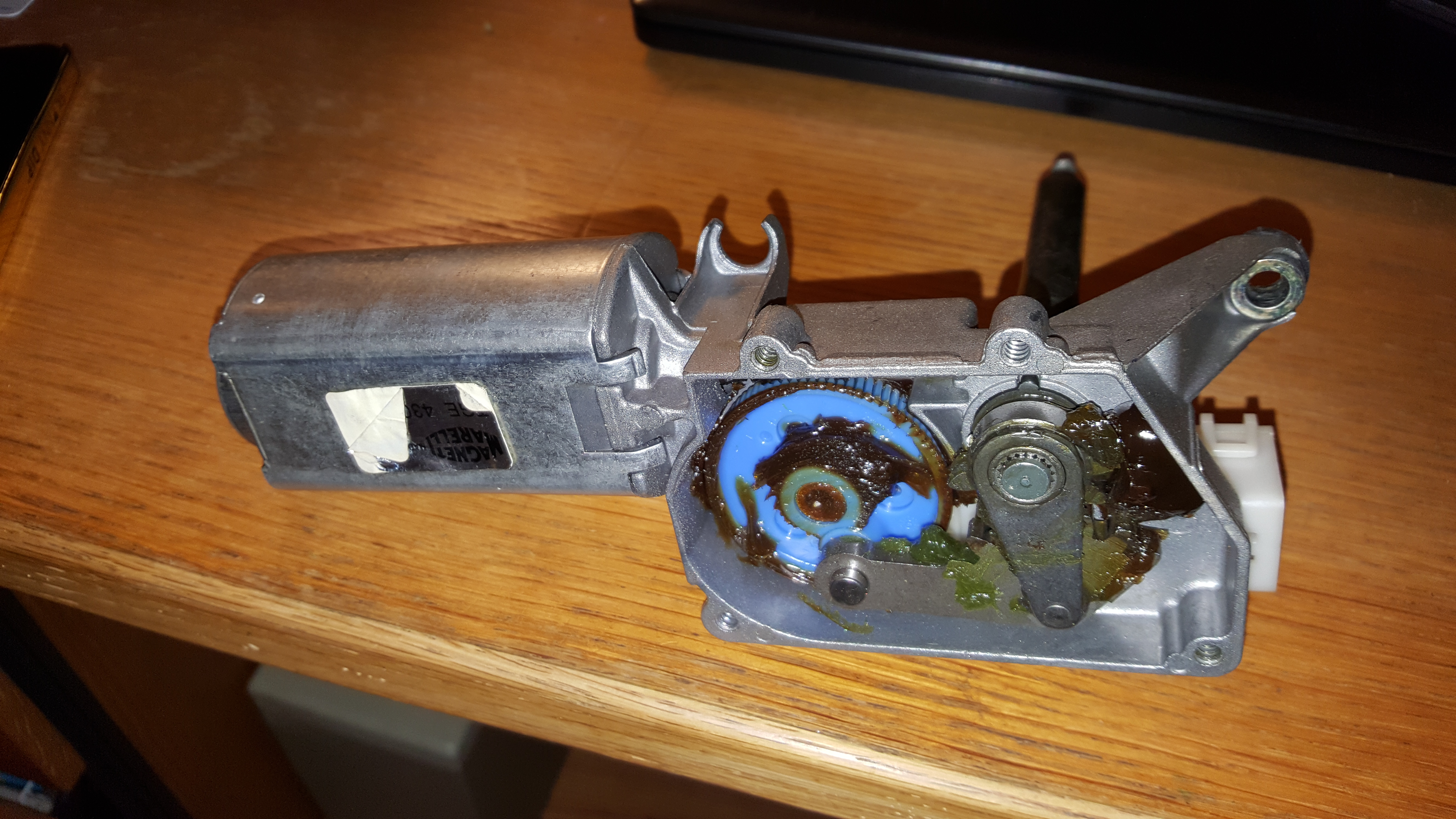

Or do I hit it from this side?
I've removed the little circlip and washer from the wiper end.
Is there anything else to remove or loosen?
Thanks
Pete
