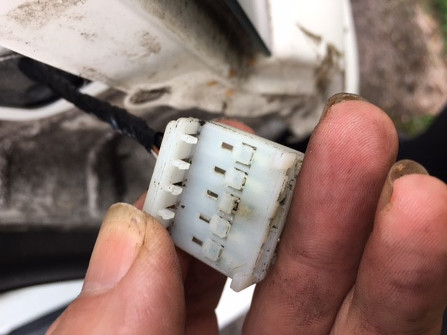

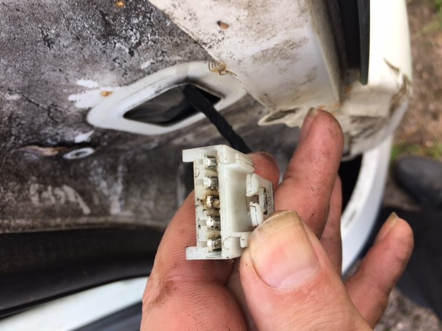

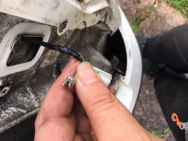

open hatch
unscrew the three Black screws
push the tab on the connector down with you thumb and pull the connector off
lift the plastic bar up and pull out the offending connector
straighten and clean with emery
put everything back and all is golden
just done mine took about 10 minutes
but then again I have done a fair few
