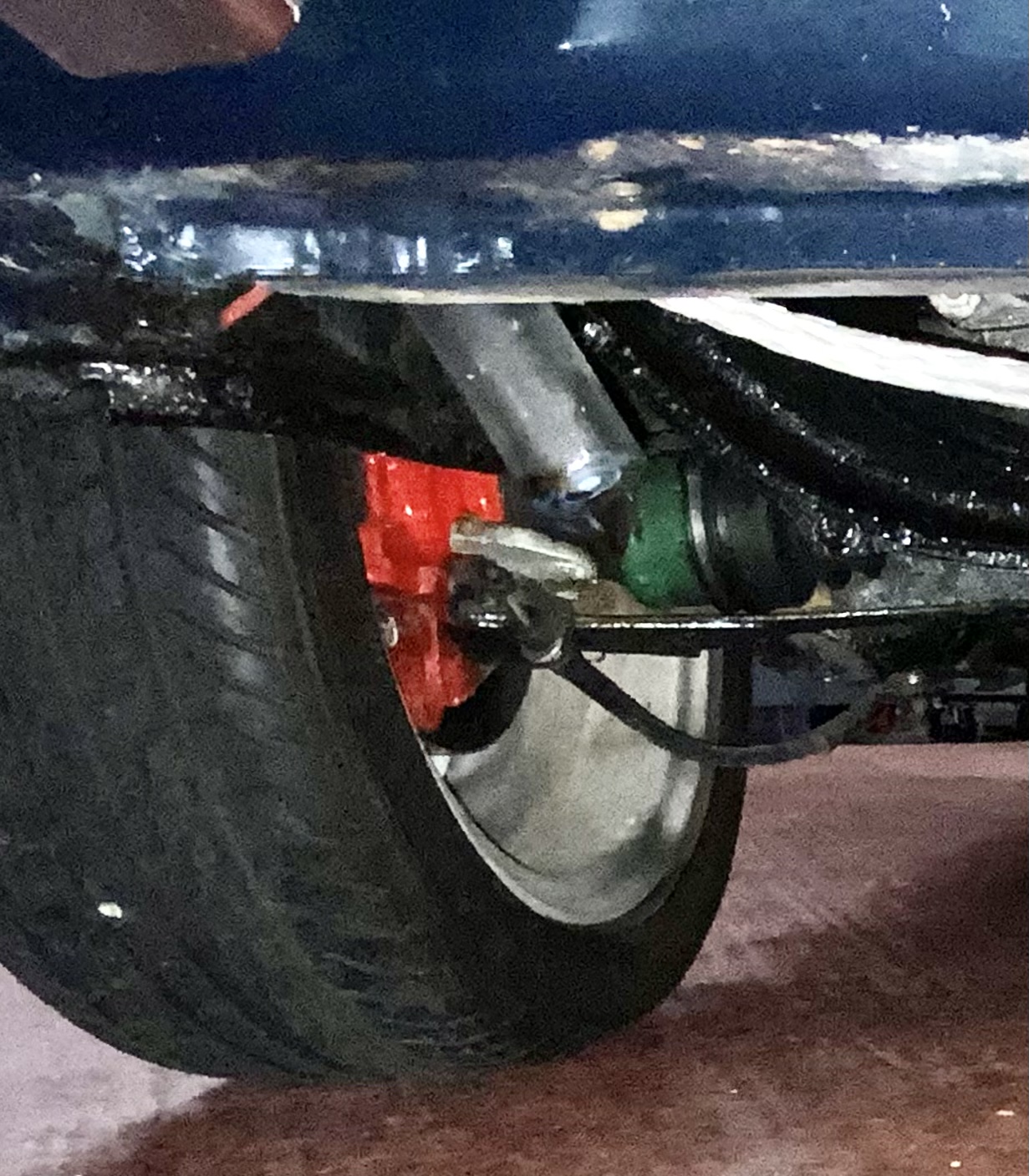

Hi Ian I have checked any abnormal movement on the wheels as you suggested they appear to be rock solid, so next is to remove the wheels & I am hoping it will be something stupid like a stone. At least it gives me the opportunity to clean & check the brakes etc, once a year I usually clean the inside of my wheels but missed last year. The photo is of the near/side from an old pic.
Many thanks for you help again
Barry
