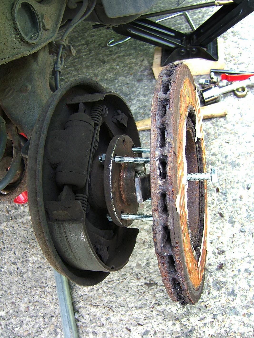

Yes, it's a good idea - as long as you can rotate the drum relative to the hub a little first. Then the ends of the bolts will push against a flat surface. I didn't do this - just used the tyre levers inserted between the back edge of the drum and the brake backplate, then gently levered it all round until the drum came off. If there's a significant lip on your drums though, you'll struggle doing it this way.

- Brake drum came off easily - no appreciable wear on the inside to make it difficult.

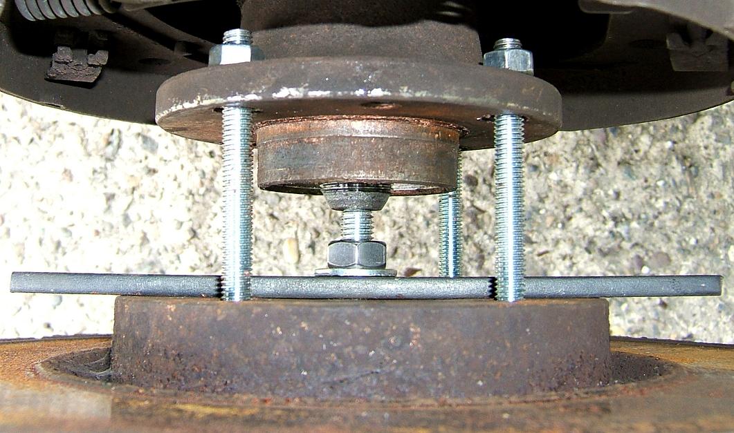

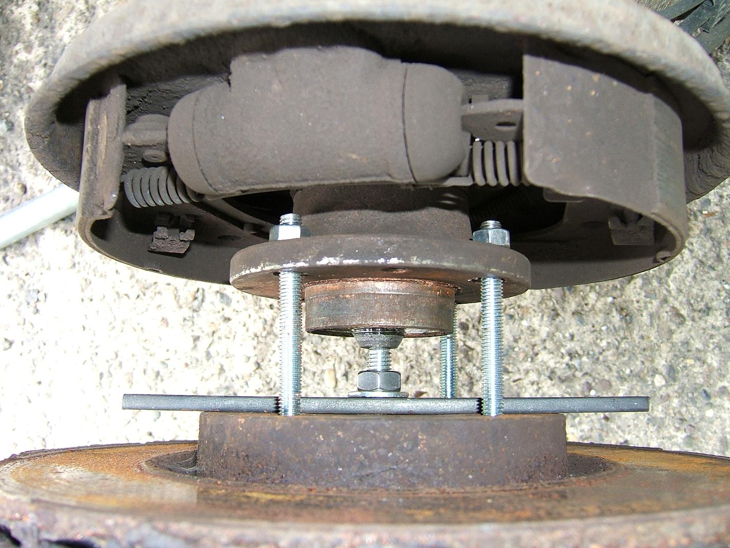

- Needed my DIY puller to pull the hub off the axle. It worked.
- Not having a puller for the inner ball race, I used a variety of tools to move it off the axle. Took 30 mins to do this. Once off I could see there was rust making the job harder. I found that prizing didn't work, required driving blunt wedge-shaped tools between the inner race and the backplate.

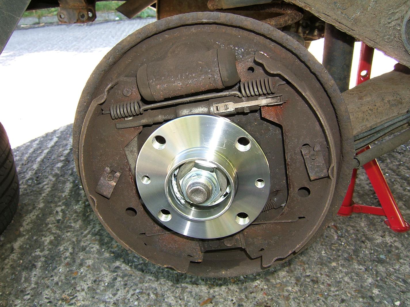

- Torqued the axle nut up to 210Nm, the max for my wrench, then used my wrench extension handle (a pipe) for the remaining Nm, as someone else recommended.
When tested, the wheel rotated unevenly (making a scraping noise at one point in the rotation), but a few stabs on the brake pedal settled the pads. Wheel now turning smoothly.

1 to 3: DIY puller

6. New hub installed
